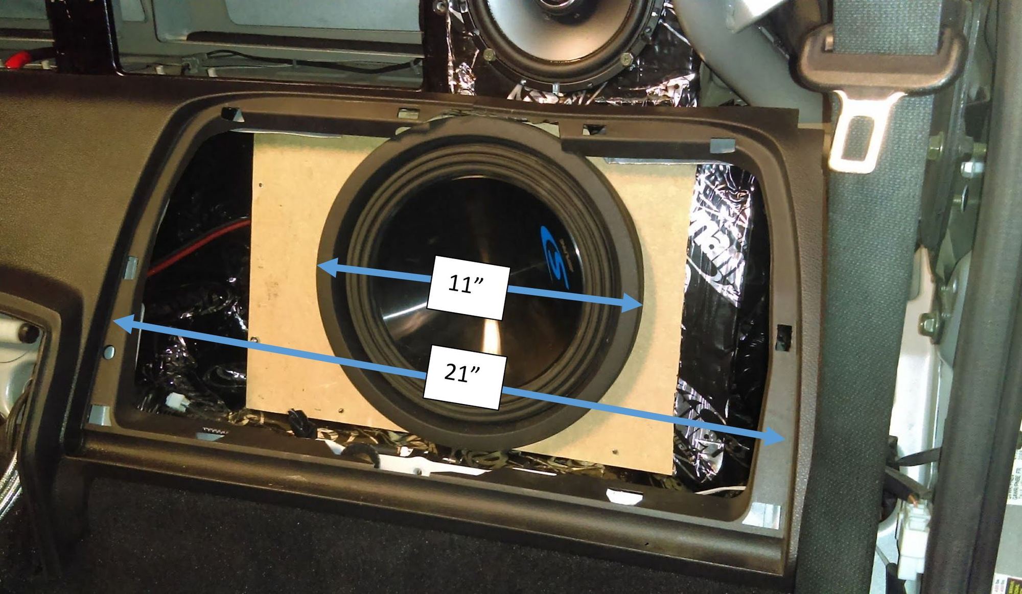

Almost done with the audio build project. Just have to put back few of the plastic panels. Designing the sub box was the most challenging part of the project. Box is made out of 0.75" thick MDF. It would have vent a lot smoother if someone had posted box plans online. Hopefully this box design comes in handy for somebody else.
Speakers are Alpine SPS-610. I have built up a pice of MDF around the speaker to eclose the speakers.
Pioneer D-9605 amp hidden under the glovebox.
Bass boost controller placed into the empty switch by teh seat heater switcher.

Nice work.
I did something similar but left all the factory metal bits in place by building a smaller box for an 8". Mine is actually attached to the factory sub bracket with the 8" firing thru the 10" hole. I only had to trim a little plastic to make it work.
I wish someone would just build a fiberglass box like this as a ready made / drop in solution. Two 8"s side-by-side with a custom cover would be perfect. Down the road I might go with a rear corner 10" box as a single 8" behind the seat is a little weak for my taste. I originally put my box loose in the hatch just for testing and it sounded better that way because the seat didn't muffle the sound. At 6 foot I need the seat almost all the way back thus it blocks the sound somewhat.

A few companies do, including SRQ in Sarasota, and they sound like @ss. Nothing but rattles. This is what I did in mine, with a single 10", and I actually think there is some sound advantage to be gained by having the woofer inside the area behind the seats.

Been there, done that. Front firing is the key to stopping the rattles. I had the SRQ box with a single Polk MM 12 and I am happier with my rattle free 8". The Z is noisy as is, adding more rattles is like ->

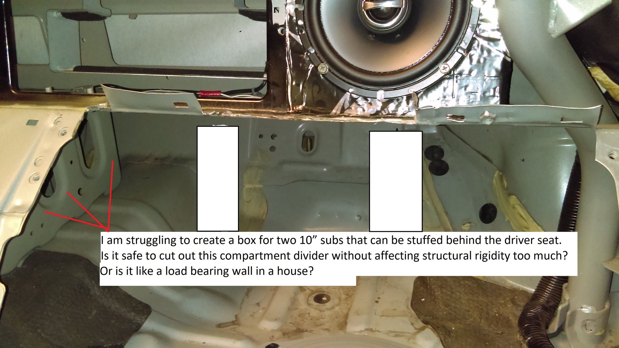

I am struggling to create a box for two 10” subs that can be stuffed behind the driver seat.
Is it safe to cut out this compartment divider without affecting structural rigidity too much? Or is it like a load bearing wall in a house?

many people have removed that entire structure with no side affects

I'm not seeing how you'll get enough internal volume for 2x 10" using just the space on one side of the car. What does the woofer manufacturer recommend? Why not just build two of the boxes like mine and give up the glove box?
Good job.
This might be too late, but I wonder if you can just make a single box long enough to extend to the passenger side and put a divider within the box itself to section off the subs..? Instead of making two separate boxes on each end of the car, you'll have the division within the box right behind the steel divider on the car. And, yes, don't be afraid to cut some steel.
