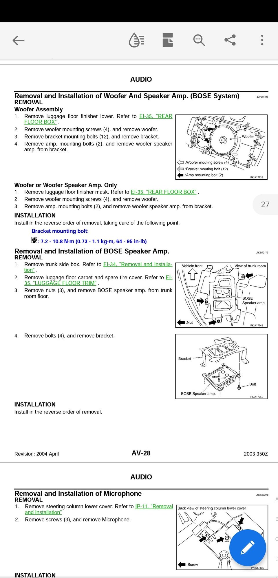

Old Jul 14, 2021 | 11:18 PM
Kaden Hartmann's Avatar
Kaden Hartmann
Joined: Apr 2020
Posts: 17
From: BC
My 03 had a speaker amp on the left side of the trunk under that foam piece
Old Jul 15, 2021 | 06:39 AM
iideadeyeii's Avatar
iideadeyeii
Joined: Nov 2011
Posts: 4,025
Likes: 477
From: Lawtown
Originally Posted by dkmura
Crutchfield is correct. None of the '03 Z33s were equipped with an amp in the trunk of the car.
My 03 had an amp on the left side of the trunk underneath.(BOSE)
I wired a new amp and brought the amp wires right to the factory amp connector in the trunk
