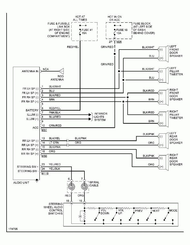

No problem. Check 15A (should be blue) fuse #41 in the engine compartment box, and 10A (should be red) fuse #18 under the left dash, if you look at the element from the side you can easily see if one is blown or not.

I cannot confirm, I got that diagram off the web so it may not be accurate, I can get a proper one on Monday but otherwise I’m stuck with Google.

My first google diagram was way off, the correct fuses are as follows.
For Bose or base system is fuse 37 (15a) in under hood compartment, and fuse 6 (10a) in dash fuse box
