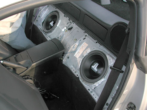

For those who have installed an aftermarket sub-woofer in the place where the Bose one is suppose to be, did your speaker screw in flush.
I installed 2 JL Audio 10's in the factory location and where my glove box used to be. They are 10w3v2's. They didn't fit perfectly, so I made due. I used 3 of the holes from one side, then went to HomeDepot and bought some brackts. I bent the brackets so that one end would attach to the sub and the other to the hole on the mounting plate. There left about a 1 centimeter space open, where I promptly dynomatted over with it and then used some dynomat tape to ensure the enclosure was tight. No rattles and they both hit really hard.
As far as the dynomat vs foam goes...my buddy used the foam and his doesn't sound nearly as good as mine does. Same subs, but he didn't dynomat the enclosure. This is not to say that those people who foamed it have horrible sounding subs, but just that my buddies doens't sound as good. Oh, and dont' buy dynomat. What a waste of money. All you are paying for is the name. Call any local roofing supply place and ask them for pricing on peal and seal. I got a 34 ft by 12" roll for $25.
This is exactly what I was asking. I did the same but how did you secure the top and bottom of the speaker. Because of the ridge on top I couldn't seem to drill through it.
By the way after spending $70+ on 2 - 4 square foot pieces of dynomat I am going to try calling around for peal and seal.
Old Mar 16, 2004 | 11:30 AM
saint01's Avatar
saint01
Posts: 320
From: ohio
got ya...i didnt' actually attach the top and bottom to the mouting plate. If you look closing in the picture, I tried to drill holes up there, but couldn't get them to work. So I mounted each sub with a total of 6 screws and brackets. If you notice in the picture, you don't see any of these because i did the mounting behind the plate. the brackets from HomDepot are farily easy to bend (some pliers and neednose will do the trick) and then just finding screws with washers and nuts that will fit all the holes.
Recap. I used 3 factory holes on one side and then bought brackets to mount the holes from the sub to the plate on the other. I bent the bracket a little on the top and bottom and put some dynomat (peal and seal) on there to eliminate the possiblity of any rattling, but didn't actually use any screws in the top and bottom locations. I have had no problems.
Does that explain it enough?
