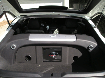

Old Apr 19, 2004 | 10:17 PM
pearl430's Avatar
pearl430
Posts: 319
From: CA
Default JL bass
want to buy my 10" JL V2
custom box and panel
PM me
yes u can even add some base to the Bose system
pix below is JL logo on top of panel

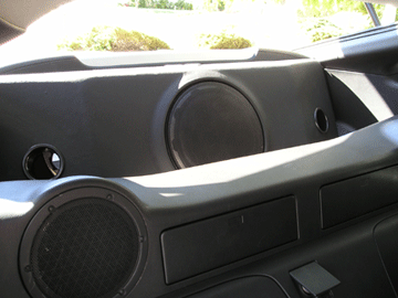

Old Apr 19, 2004 | 10:18 PM
pearl430's Avatar
pearl430
Posts: 319
From: CA
Default JL bass
from inside

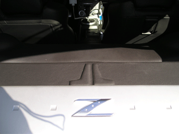

Old Apr 19, 2004 | 10:19 PM
pearl430's Avatar
pearl430
Posts: 319
From: CA
Default JL bass
from rear, plenty of room in trunk
