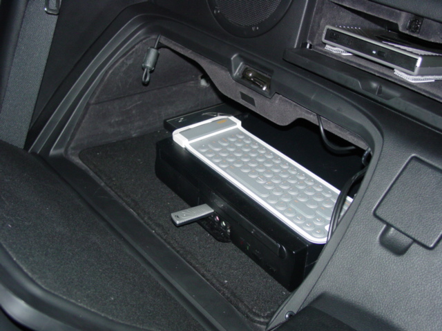

I couldnt log coolant temp too cause I dont have a ctrl key to hold
You need one of these:
