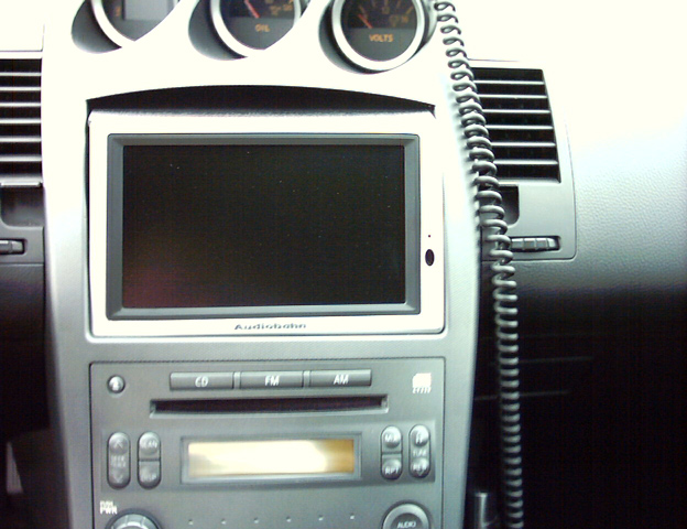

The 7" Audiobahn screen comes with remote and wireless headphones....its cost was 320 from circuit city.
Old Jun 2, 2004 | 08:15 AM
thunder0880's Avatar
thunder0880
Posts: 452
From: Mississippi
Attached Thumbnails What kind of LCD Screen do you have?-audiobahn-screen.jpg

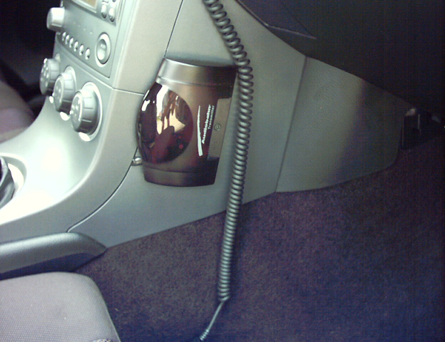

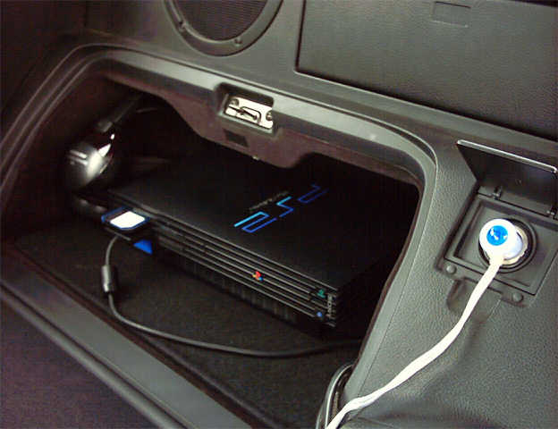

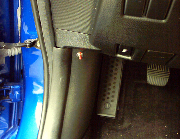

Attached Thumbnails What kind of LCD Screen do you have?-fm-modulator-switch.jpg
Old Jun 2, 2004 | 08:25 AM
thunder0880
Posts: 452
From: Mississippi
The second pic is the reciever for the headphones, and the switch is for the fm modulator.
