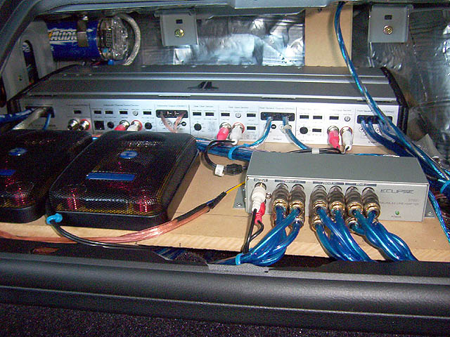

Been very happy with these....
http://www.knukonceptz.com/productMa...0Interconnects

You have any hiss noise in your Eclipse? I have the CD8053 and the 37601 balanced adapter, I hear some noise. I'm thinking change the patch cables. How many feets long are your cables?

Fergraz,
No noise with my CD8061. Dead quiet between tracks or transitions in music.
My cables are 6meters which is way too long for where my amp rack currently is. I plan on building a small rack to go between the "hump" and rear strut brace.
With the BLA you shouldn't have any audible noise. Check all the normal stuff, good grounds (no paint between connector and ground) routing of cables around the little box supplied with your eclipse deck. Keep your RCAs away from that little guy.
