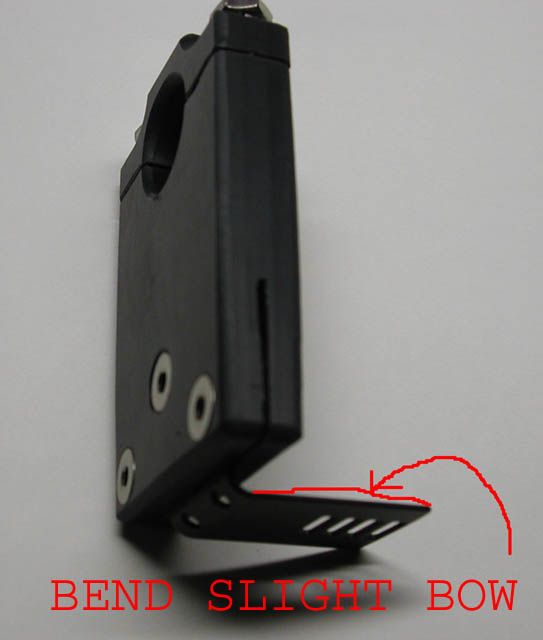

Default DETECTOR RATTLES
The detector rattles because the slot in the detector is bigger than the thickness of the suction cup bracket. If you bend the male end of the suction cup mount so that its tight going into the detector slot it will stop the rattle.
Mike
