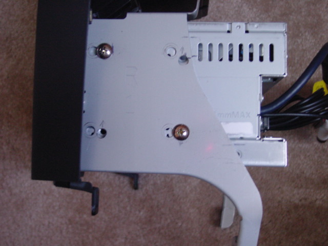

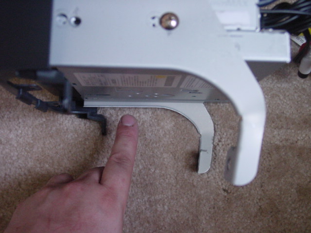

Found this too...
This is what Mark (Phatmitzu) was referring to when he said he had to drill new holes in the stock bracket.
The HU will stick out about 3/8" to far, so drilling new holes that much further back, gets it flush
I started with the top left hole there, and then did the top right.
To make sure I had the right angle, of how the HU sits in the dash, I used the stock braket as a guide, so that it was good and level
All taken from this thread
Also look here
