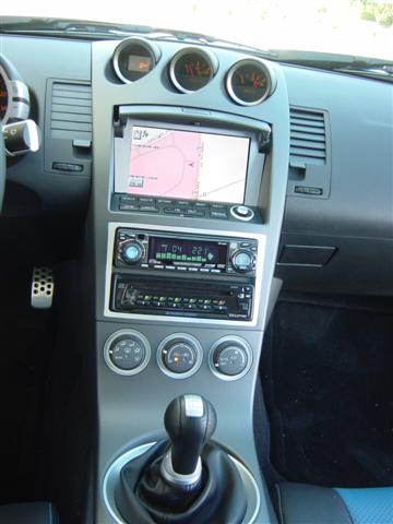

ok.. so to that i added an Eclipse CD5442 Headunit, Eclipse 6-disc in-dash changer, kenwood amplified center speaker, more dynamat xtreme for rear hatch, and brushed aluminium trim for radio and nav screen...
aftermarket headunits dont have the ability to accept an AUX in AND switch to it automatically...
so this is what i did....i got the nav voice working through the amplified center speaker because the nav unit actually generates a line level voice output. the next problem was figuring out how to mute the aftermarket radio when the voice comes on so i can hear it... see, aftermarket radios have "telephone mute" inputs, which activate when the input senses ground.
the problem is the stock navigation uses a +9V signal to the stock headunit to tell it to mute the music. what do you do? easy.. you go down to the electronics store and pick up a 6V relay. use the nav +9V signal to trip the relay, and use the normally open to ground, and the common to the telephone mute wire.
so what happens when the voice comes on...? well the radio mutes (with a display of "TEL MUTE") and then the voice comes through the center speaker... when the voice stops, the radio turns back to normal volume .... awesome!!!

i really like the look of those aluminium trim pieces,.. it matches stock pieces exactly!

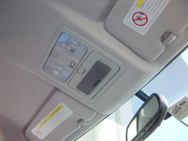

here is the center channel speaker... finally a use for that dumb sunglass holder...

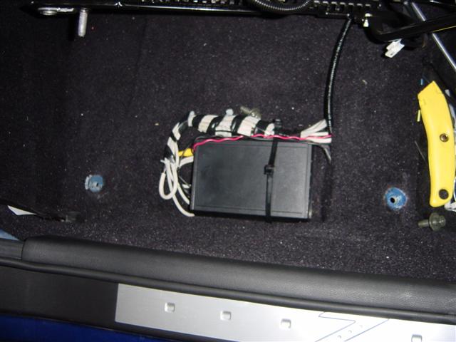

anyway... here is the RGB box under the passenger seat. nav-tv doesnt really send long cables, but luckily they use DB9 cables... i had 2 extra extensions to move the box further away.
m

How do you remove the sunglass holder/dome light unit that's between the sunvisors. Is it snapped in or are there some hidden screws?
