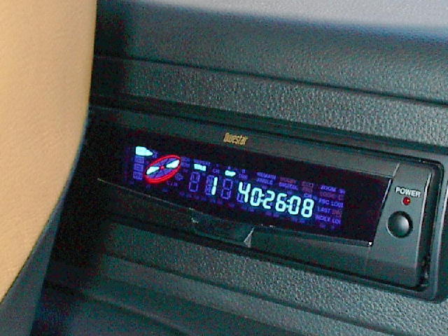

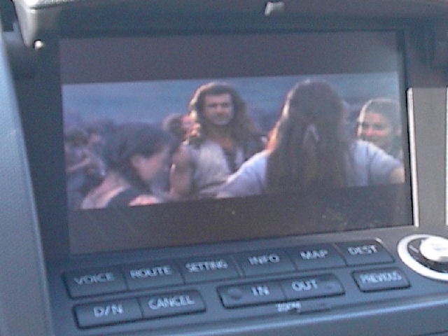

I am attaching some pics of my dvd player, screen, and video game hookup. My installer did a great job and the video game plate is great. The power converter is hidden under the storage compartment. I just plug the audio, video, and power up and it goes straight to the nav. screen. My toggle switch is next to my VDC switch. It is black as well. I am really happy with how my installer did everything. Great upgrade.
Sorry that some of the pictures are fuzzy. I'll take some better pics.

Pic of my dvd player.

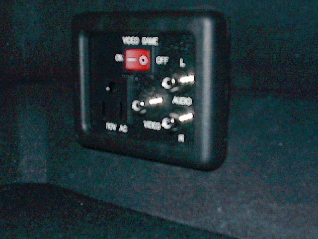

Pic of video game plate.

Very sweet and clean install. Did you order an RGB converter to tap into the Navi feed? You also referred to the toggle switch - this means you still have Navi capability? Please provide details - I would love to do this but I cant find anyone in So. Florida to help.

I ordered the RGB converter from Nav-tv. An installer has to order from them and get setup to do business from nav-tv. I still have my navigation. I can just hit the toggle switch and it changes from dvd to my nav. So, if I get pulled over, I can just tell the police officer that it is just navigation. Just call nav-tv and talk to someone there. Just tell him what you want and get his name. Contact an installer that you trust and tell him what you want. He can call and get all of the info that he needs. They send all of the diagrams to the installer. My "eye" for the remote is hidden to the right of the steering wheel. You can not see it, but the remote works great.

My dvd player was around $400, Game plate and power converter about $100. The rest about $900 for labor and the RGB converter, as well as toggle switch.
