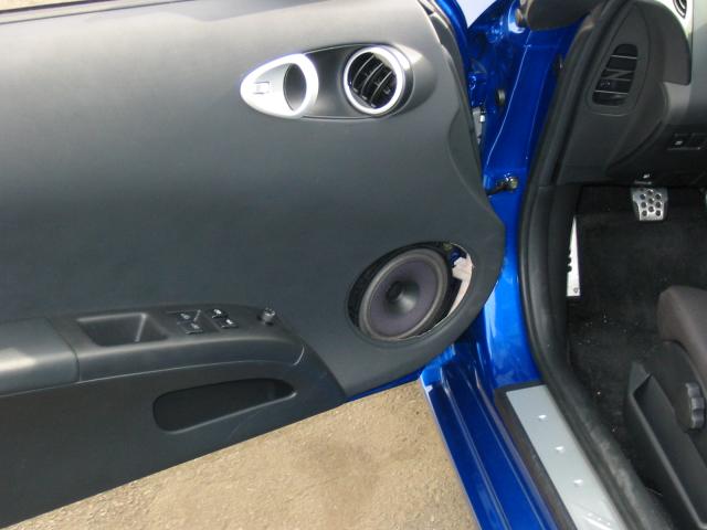

A few minor setbacks kept this from going a smooth or as quickly as I had anticipated. First the Kappa's drivers are much deeper than the stock Clarion speakers. We had to buy 1 inch spacer rings to all the windo to roll down all the way. Also, the calrion speakers have a notched mounting bracket that is also needed. Best Buy car audio had all the needed parts in stock, and cheap. (~18.00) Here's a Pic of the stock speaker in the door.

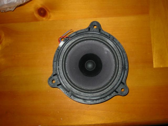

The speakers in the stock stereo are poor quality. Even if you dont want to replace the head unit, these speakers have to go. Here is a close up of the clarion door speaker with the slotted mounting bracket.

Here's a pic of the Kappas installed into the passenger door. The door installs were easy to do, but the speakers behind the headrest took some effort. The entire back area had to be removed. After seeing the effort involved, I am glad I paid to have this done instead of attempting it myself, the install cost was worth it, considering the headache this would have given me. Besides, you cant drink Newcastle on draft and watch a football game on the same day your going to do this work, if you do it yourself.

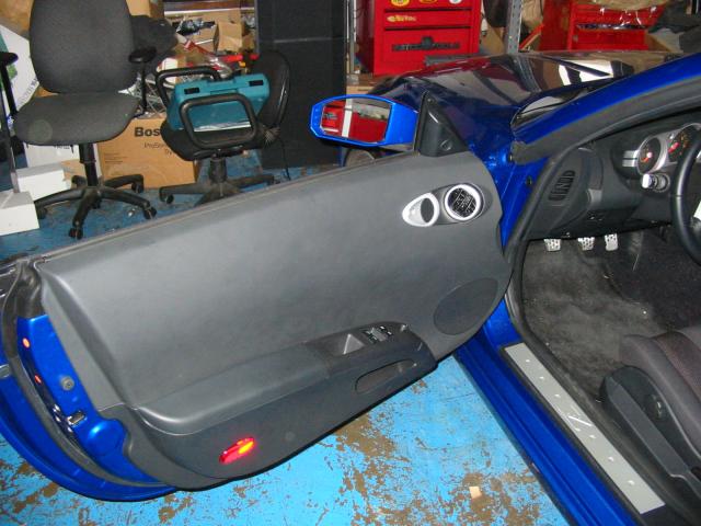

Here are a few pics of the finished install.

here's a pic of the door install.

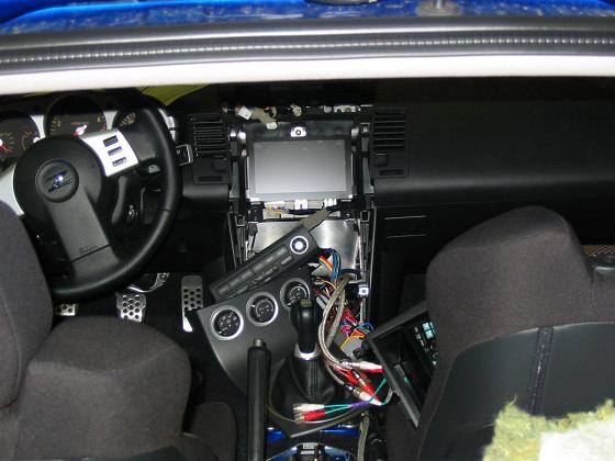

And one last pick of the Head Unit. The guys at Newport Audio did an awesome jobn on the install, and were able to knock out both cars in about 10 hours. The end result is a stereo system that sounds really good, and will serve as a good foundation for the forthcomming amp, and sub install.
As an aside, the tech got to drive our cars a total of a block. In that short time he noticed a difference in our two cars. As did I. LowFuel has an earthing kit and K&N filter. I have stock. I beleive I will be changing out the stock stuff in the next week or two. Pics will follow.

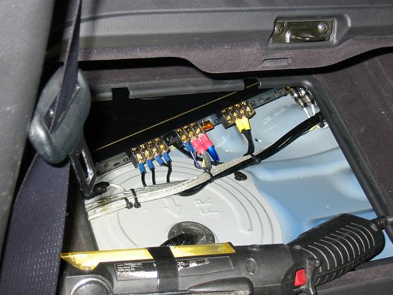

I refused to give up storage space. So the install couldnt take away the bin behind the passenger's seat. So we installed the amp under the bin.
The system sounds awesome, its plenty loud, and can produce alot of deep bass. I was suprised at the tightness of the bass in some of the sources. The speakers I installed in the headrests could have been left out. They dtract from the music, and muddy the image. I left them unamplified. We amped the front Infinity sepakers, and used the second pair of channels to bridge the amp.
Here are the pics:

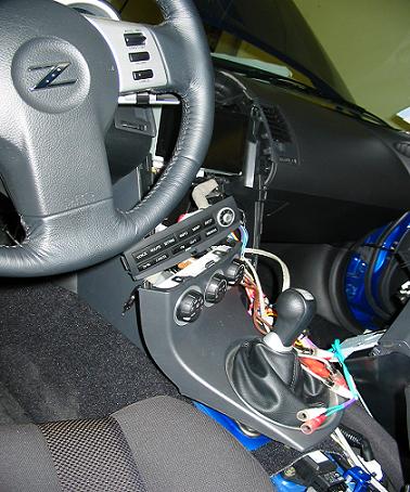

Here's another pic of the car in vivisection.

Here's a pic of where I had the Zapco installed. It looks like it's skewed and just laying there, but it is fastened quite securely to the frame and doesnt move at all.
