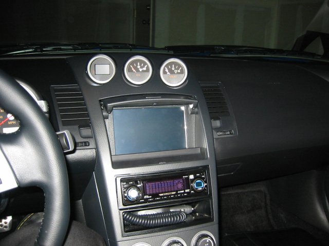

Ok finally got a real Digital Camera Here are a few pics of the screen. Also a shot of my Eclipse 5441 Head unit.

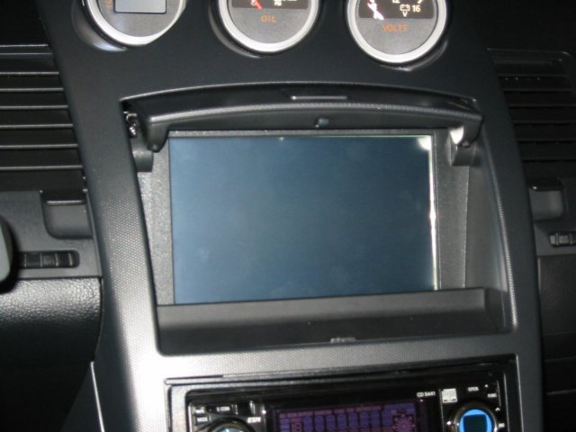

Another Pic

is it broke?
well turn it on then! we want to see it ON

Someone installed your dash kit wrong ;-) The top bracket is upside down.

dmazyn, I bought the Xenarc 700YV 7" LCD which is just like yours but without the touchscreen part and I was looking at the pictures you took of your install and had a question. How did you get the LCD to fit in the compartment? I took the LCD out of the case and tried to fit it from the front of the compartment just to see if it fits and I couldn't see it fitting. This weekend I'm installing my car PC, LCD, HU, amp, and sub. Do you have some information you could share on how to fit the LCD in the comparment?
Thank you,
zaway

You have to fit it from behind the compartment. You can use some double sided tape in between the protective screen cover and the back side of the plastic compartment. A little trick to hide the tape from the outside is to take a black sharpie and use it around the outside edge of the tape before you apply to the compartment.

seems like doubleside tape is what everyone is doing to secure the screen. but don't dust/lint get stuck on the edge?
