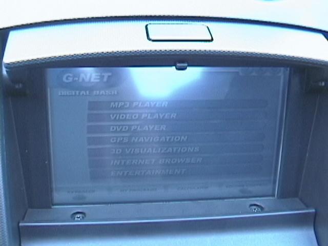

Pic of the front:

Old Mar 7, 2003 | 09:00 PM
dmazyn's Avatar
dmazyn
Joined: Jan 2003
Posts: 284
From: Austin, TX
Pic of screen installed in the car:

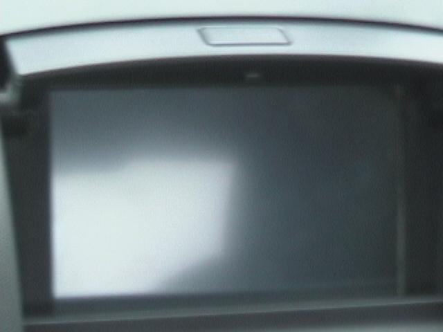

Some new pics in better light.
First one is the screen turned off.

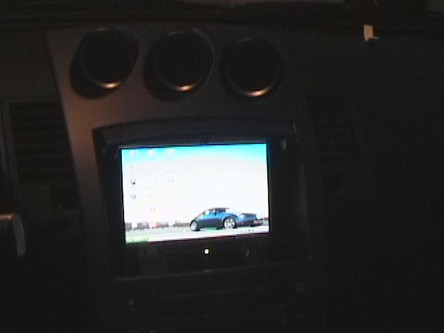

Old Mar 8, 2003 | 11:43 AM
dmazyn's Avatar
dmazyn
Joined: Jan 2003
Posts: 284
From: Austin, TX
One with xp desktop shown.
