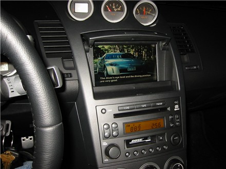

Hi, I have just worked on my friend's 350Z recently. I custom installed an Alpine Tme-m760 6.5inch lcd into his car. The Lcd fits prefectly with some proper cutting. Here are some pix:

It looks like the bottom and sides are cut off... unless the pics are wrong... was it an easy install beside that?

It took me about 5 hrs to do everything (including installing the headunit)

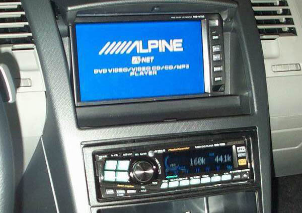

better pic:

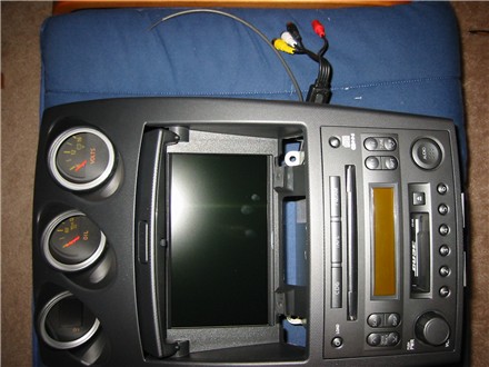

a pic of the area that I cut:

getting ready to do this myself... could you outline the areas you cut? Also, how did you cut it? I'm sure my jigsaw would make mensed meat out of that plastic.

he obviously cut to make room for the buttons that are on the side of the screen, tho he did a great job and you would never imagine that it was cut... looks totally stock..
youd only run into problems if you wanted to remove it, but Id imagine that part is about 5$ at most.

So far, every single Alpine monitor that has been installed in the 350Z has had to have some "minor" cutting done to make it fit, including mine. The Fahrenheit monitors, from what I have seen on this board, do not require any cutting.
