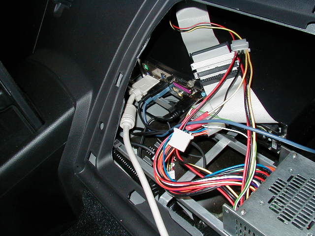

Can someone, please, tell me, when you install Xenarc and run the VGA cable through the console to the glovebox area, what's the farthest point the connector will reach? Maybe, someone has a picture that will give me an idea of how long that free end of the cable is?
Thanks!
Thanks!
Thats pretty hard to say, depending how you run your cable. If you did it the way I did (as shown) you going to lose maybe a foot or so. Just buy an extention VGA cable. That way you can run it anywhere you want.
I bought a VGA extension cable, and also a serial extension cable for the touch-screen. I did not need to use either of them.
I ran my cables through the console, and ended up with only about 6-8" of cable left in the compartment behind the drivers seat. I had to rotate my computer so that the front of the PC is actually pointing to the rear of the car. Makes accessing the DVD drive very tough, but, I don't plan on using that drive, except to possibly hold a navigation CD/DVD. I have another drive mounted in a mailslot which I use to load software, movies, etc.
I'll look and see if I have a pic.
The pic below shows how mu computer is installed. Although this pic shows an external VGA cable hooked up to my computer (I was trouble shooting a video problem at the time), you can just barely see the end of the video cable from the xenarc underneath the bundle of power cables.
That is how much of the cable I was able to get poked into the compartment.
