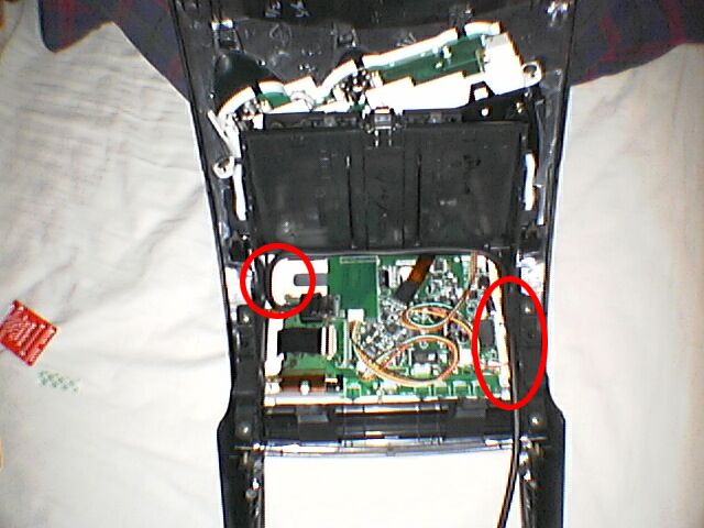

Finally got down to the wire and installed my Xenarc screen. Double side tape and few minutes later, installed. Man what a super easy install.
Heres a pic of the back. I was worried about the connector coming loose so decided to use the cable to push the connector in. In the circle is where I use double side tape to secure the cable from moving. Just bend the cable so that it uses the Dash's side to push the connector in.

Im sittin here trying to figure out what their doin there... I had the touch screen and that brown flat cable up top was connected to the touch screen controller... but you have the cable, and not the controller, odd.... the cable should be attached to the touch screen overlay.

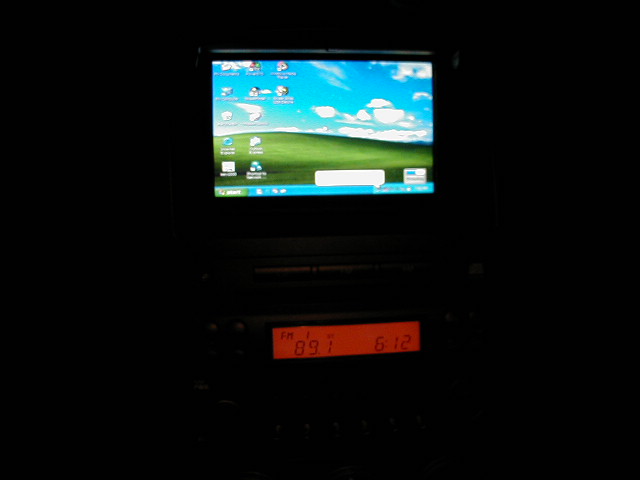

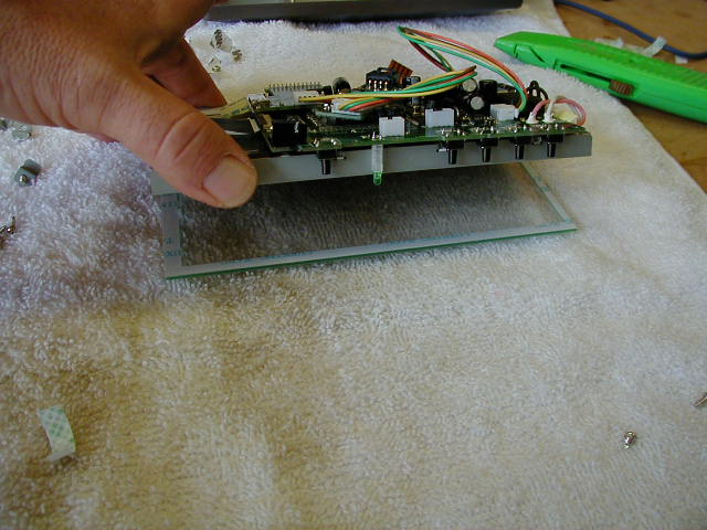

Got mine installed today too!
Sure wish I could say it was easy, but I had a tough time getting the screen in. I don't know if the touch screen makes it harder, or I am just all thumbs. The touch screen is an 1/8" thick piece of glass,with a paper border on the side that touches the screen. I could not find an adhesive that would hold this paper to the screen. Well, I tried 3 anyway,the last being superglue. No luck.
So I basically used strategically placed tie wraps - across the back, and around the sides. Held in firm now.

Happy with result....except that I am having some intermittent loss of video signal. I'm pretty sure it is the end of the vgacable where it attaches to the computer. If i bend it a bit,the picture will come back. Then again, maybe one of my other 9 thumbs is touching the real root of the problem when I am bending the cable.

The controller is there, it's taped to the main board (you see the brown ribbon cable, it from the touchscreen to the controller) It was stuck there when I opened it. Look at Scafremon's pic, its the same on his.
