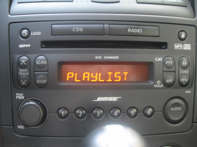

After waiting and searching for some time on a 2007 ipod controller, I purchased this item made by Axxess from Integration Solutions on ebay. A little expensive but I am very pleased. Like most I wanted to be able to control my ipod through my radio. I also wanted it to show the song title, artist and so on. Well I am very pleased with this item. Not only does it display the artist, or title but all my ipod controls work through the radio… NICE !!
I will note that to get it working in the beginning took some time because the instructions for 2007 are a little different than what is provided on the sellers ebay site. So that took some time and frustration. But once it works its great.
http://www.axxessinterface.com/
Anyways here are some pictures of its operation:
Navigation through Main Menu:
Attached Thumbnails -picture-016.jpg   -picture-017.jpg   -picture-018.jpg   -picture-019.jpg

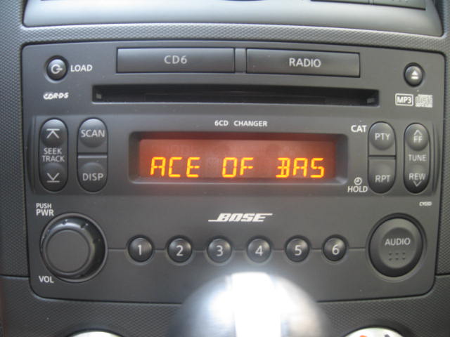

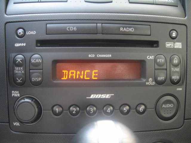

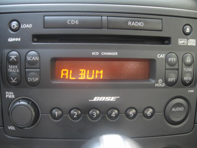

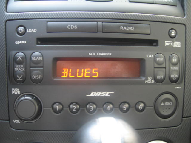

Here is the Selection of Genre and Showing the title and song playing. I can be here all day with more pictures of available menu items, but I think you get the idea.
Also, this maybe on the radio instructions and I should have read those, but for those who are like me. If you press the DISP button (sometimes holding it down) it will show you the song and artist on your FM, and CD's as well...Nice! OEM is not too bad...

Ace of Base... ha ha
looks good, tho.

Also, to help you out just a few difference from their ebay site for the 07Z (at least for me).
- to get out of Ipod and back to your FM, AM and CD. You need to double click on radio. Similar to double clicking on a pc mouse.
- when I first connected it did not display the song title or name. You need to hold down the DISP button for a second or two. You will see it change to name. If you let go it will show the name (I think name = playlist). Hold down again it will change again and show title and so on. You can continue to hold down so you can see the different text it can show.
- you also need to setup your 1-4 preset to be able to navigate through the ipod menu. At first by pushing these presets nothing happens. All you need to do is hold down each as if you were setting up a channel. Do it for each one. Once complete, you can use them to navigate the ipod:
A) Preset Recall 1 is the Browse Up key.
B) Preset Recall 2 is the menu start and cancel browsing key
C) Preset Recall 3 is the Enter (select) key.
D) Preset Recall 4 is the Browse Down key
If I remember any other troubles I had I will add more, but I think thats it. And dont worry about the presets it does not impact or change your FM radio presets.
