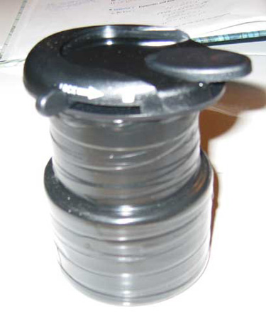

Anyway, get a length of 2" PVC pipe from the hardware store, and cut off 6" or whatever looks like a good fit for your car. Wrap duct tape around the base so it'll have a nice snug fit in the passenger-side drink holder. Check fit in the car before going on. It should be just snug enough that you can put one layer of electrical tape around and you'll still be able to get it in the holder. Buy one black hard vinyl floor tile (or suitable alternative) and use a jigsaw to cut a circle the size of the pipe. Glue the circle to the top of the pipe using liquid nails or the like. Then to give it a less-crappy subdued look, wrap the whole gizmo in black, low gloss electrical tape. Finally, take the permanent adhesive disk for the Garmin, and trim it to match the tile you glued on top. Adhere the mount and let the whole thing dry overnight.

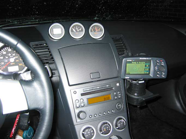

The finished product:

Mounted in the drink holder:

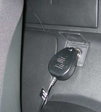

The Garmin combo power cord/speaker:

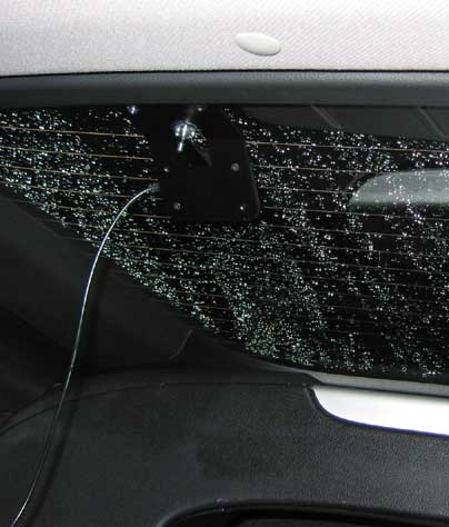

The remote antenna (~$75), which gives much better reception:
