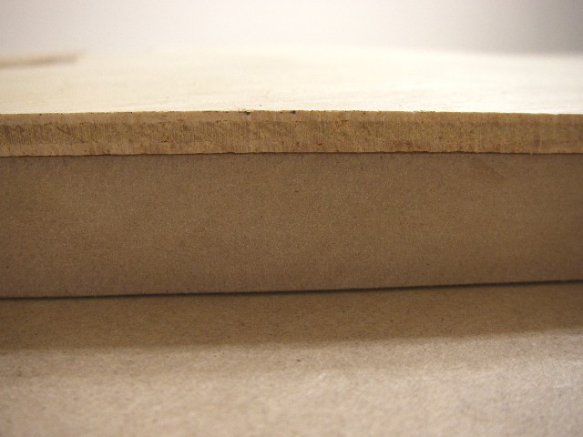

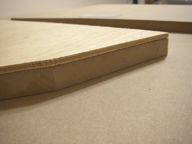

Saturday I made good progress. Woke up early and hit Home Depot again. Picked up some liquid nails and a sheet of 3/4" MDF. One item I couldn't find, which I will need soon, is a compass or device that can make 10 or 11 inch diametered circles. The biggest they had could only make 9" circles. When the sub arrives, it might have a template to trace, but I don't want to take a chance.
Can anyone tell me where to pick one up?
I took all my measurements down and made a sketch on paper, being careful and making sure to double check all my measurements. For the side panels, I just traced out the old thinner plates, cut out new ones from the MFD, then used liquid nails to bond them together. I placed heavy cinder blocks on them so the two pieces of wood would mash flush with eachother. They sat all night and cured...

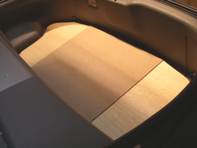

Here's a few test fit pics of just the side panels in place. You can see how much more the floor board will be elevated compared to the original baffle board...

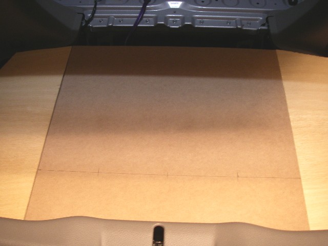

Here's a few shots with the new top baffle board in place. I haven't cut the hole out because I need a large compass to trace the circle and I'm still waiting on the sub also. In the last pic you can see I've already made the measurements as to where the center of the new hole should be, in realation to the original baffle board. I just recieved an email from FI by the way. The sub was built and shipped today. It will arrive on Friday.....
