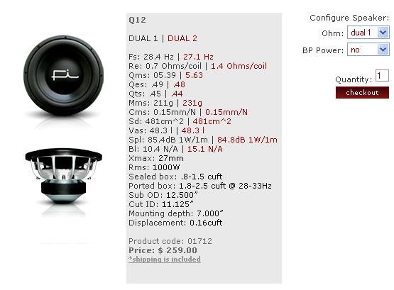

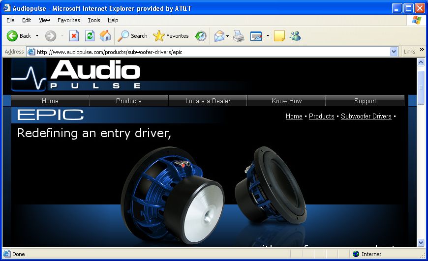

Some of you guys may have read my recent thread, searching for an ideal sub compatible with my current enclosure and power:
https://my350z.com/forum/audio-and-video/319968-opinions-on-the-fosgate-p3-series-subwoofers.html
After 6 long pages of deliberation, research, and discussion with 350zspl & StreetOC192 it was narrowed down to 2 subs. The 2 subs were the FI Q series 12" or the Audio Pulse Epic 12"(formerly TC Sounds).
(Pics of subs in attachments below )
In the end I decided on the FI Q. It'll be powered by 800watts x 1 @ 4ohms from a Rockford Fosgate P8002 amp in a sealed enclosure.

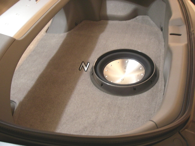

Here's what the sub looks like with the factory trunk mat in place and without it. As you can see, the enclosure is built into the rear spare tire well. I added thin side plates to create a new firm floor board on both sides of the enclosure. It's a quite simple and effective design. The inner airspace is exactly 1.25 cu ft + the displacement of the old RF T1 sub basket. The T1 sub called for 1.25 cu ft of usable air space, so that's what I built. I believe the basket displaced something like 0.30 cu ft, which would make the inner space 1.55 cu ft or so.

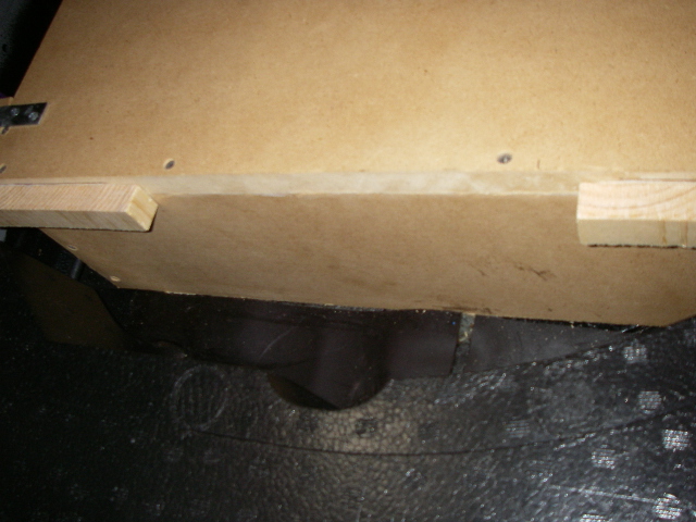

The side plates were necessary in order for the entire trunk floor board to be level. Without them the factory mat drooped on either side of the enclosure. To make the side plates sit level with the top baffle board of the enclosure, I glued tiny blocks of wood on both sides of the enclosure. This way I could rest the side plates on top of the blocks without having to really attach them. I did this so I could lift the side plates and have secret cubby holes for storing beer.

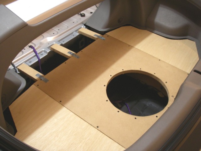

Here's some inner shots of the enclosure. As you can see, there is no bottom to the box. I made 4 corners to the enclosure and bolted them straight to the car's metal bottom using "L" brackets. Everything is sealed air tight using liquid nails. The advantage of having the box attatched in this manner is that no thief can pull your enclosure out without destroying it. The inner bottom of the box is layered with sound dampening as well. I also cut the old spare tire mounting hub off with a Dremmel high speed cutter, then layered the sharp edges with silicone to avoid cuts ect...

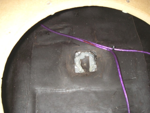

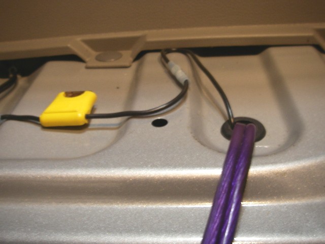

Here's a shot of how I'm supplying 12vdc to the antenna booster. You can also see how I get the speaker wire into the cubby hole where my amps are located. I simply drilled a large hole, then added a rubber grommet to it. This way the speaker cable won't get severed on the metal's sharp edges..

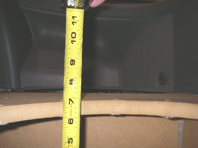

Next comes the reason why I have to complete a makeover on the current enclosure..... "Mounting depth". The new driver requires 7" of mounting depth. My current set up only accomodates 6 3/4". After discussing this problem with 350zspl, we decided the best route would be to just add another top 3/4" baffle board to the existing enclosure. This will create 7 1/2" of mounting depth, clearing the 7" requirement for the FIQ12.
Sounds simple enough, not really. I will have to raise the entire floor board as well, so the factory mat doesn't appear to droop. I will most likely have to create a new floor board for the area on top of the speaker wire and power antenna fuse as well. That area worked fine without a new floor board on my old set up, but will most likely look akward when i raise the box baffle board another 3/4".
