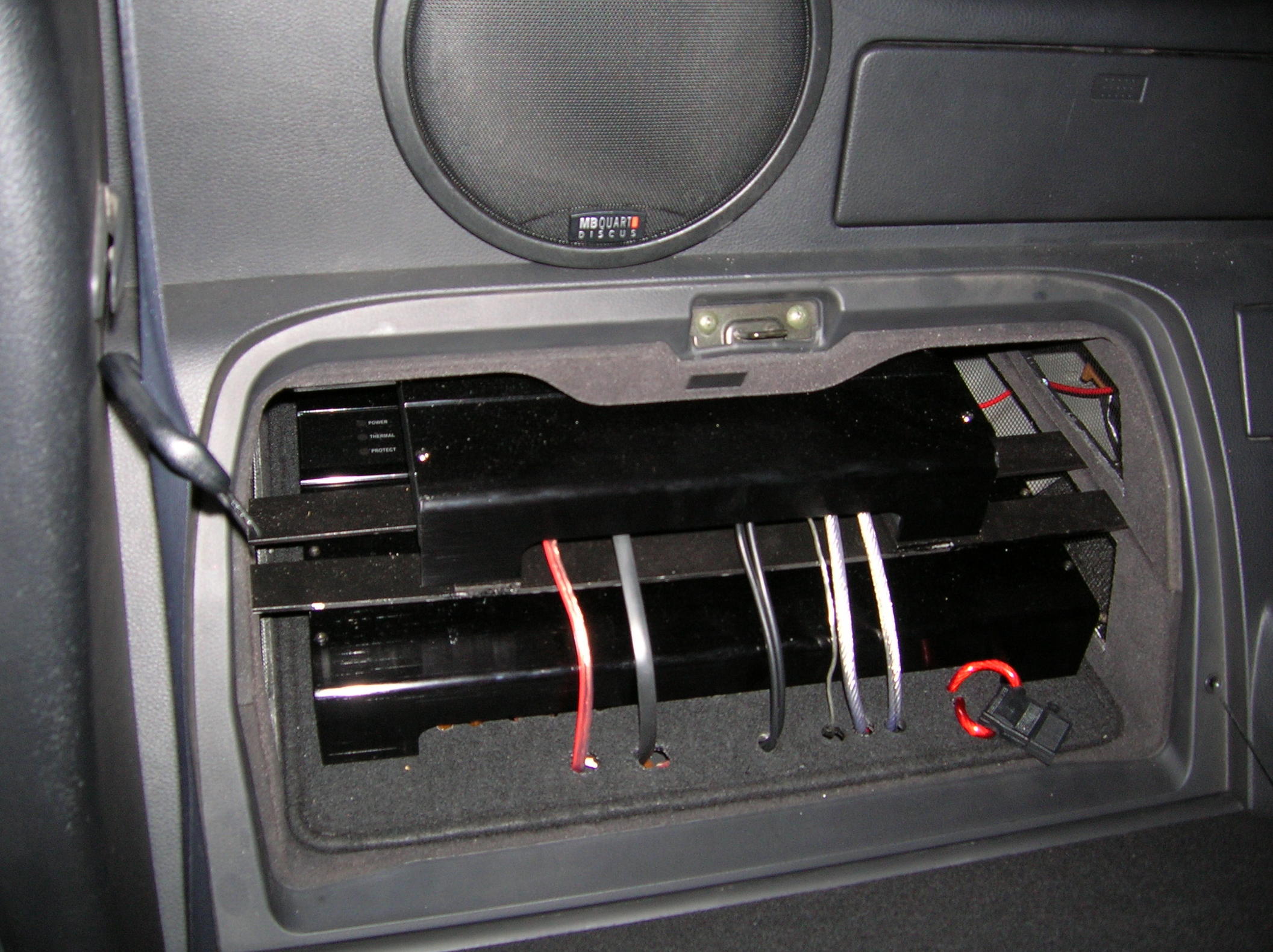

I took the glove box out, and took the two halves apart. Then I went to hardware store and bough flat metal pieces, cut them to size and painted them black. I cut some slits in the glove box for heat dissipation and put a fan behind them both. Then I put everything back together with some glue to hold the halves together and put the box back in. Pain in the *** to do, but it works.
Attached Thumbnails Amp in back compartment help!!-car-4-.jpg   Amp in back compartment help!!-car-6-.jpg
