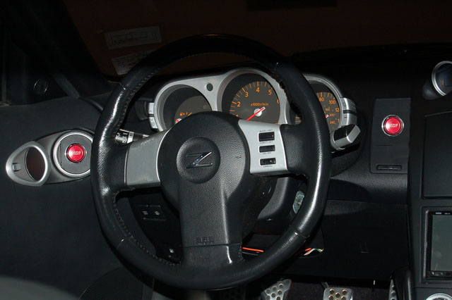

Had a couple PM me asking for pics for ideas to where I put it on the G35. Enjoy!
Wow, that looks OEM! What was in that location that it's already indented like that with a nice, circular place for the button? Or is that entire panel custon fabbed?

Thanks for the compliments guys, I was very pleased with the outcome as well. Regarding to the placement that is actually the cigarette lighter that i removed and refitted the hole to the s2k button.

that looks freaking awsome in the g35. Is that custom fitted? I know i dont have a cigratte lighter there on my 06 g35

Mine is an 03' so there is a cig lighter in that area so i just removed it and refit the hole to fit the s2k button.

Here's my stab at it. I try real hard to keep my car looking stock so i mounted this sucker in the left air vent. I am VERY happy with the result. I retained the ring around the vent and color matched the plastic and it looks like a stock button. Here you go......

Dang, are you crazy!?!? That's the better vent out of the two that you have on the driver side. You know how hot it can get in the summer. I'd never do that. I love my AC too much.

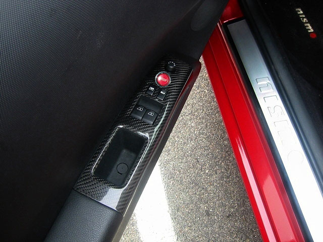

that is pretty crafty, but he is right, I would miss that vent waaaay too much, its the only one that does anything. I did a couple *quick* chops of the button on the other vent if you covered that over.
Then I had the idea well what about the door panel where the window switches and stuff is. I know it would probably stick out a little from underneath, but that could be taken care of.
I've used my AC twice in 2 years. But i'm originally from Cali and we always have the windows down... I also tested out how it feels and it was fine for me.
