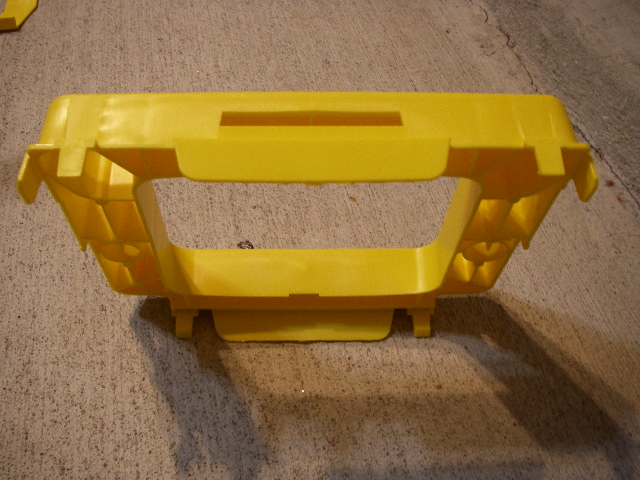

The 1st thing that has to be done is the purchase. The best deal I found was at Low Cost Batteries.
http://www.lowcostbatteries.com/product_p/d35y.htm

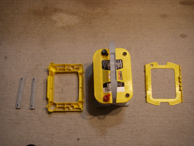

For $169.00/shipped, you can't beat that price. They shipped it on Friday and it was here the following Monday. Here's a few pictures of what comes with the purchase. If you notice, the battery comes with 3 sets of brackets. I've included close-ups of the bracket we will be using. It's the one the raises the height of the battery about 1 inch.

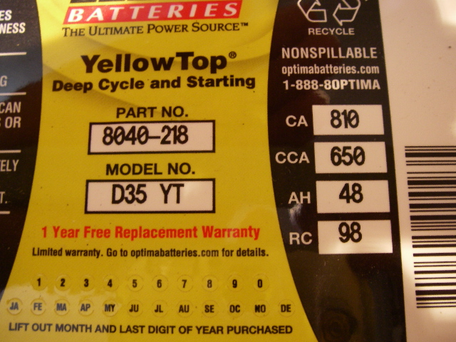

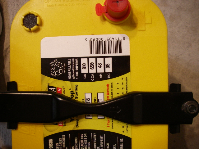

I've also attached a close-up of the top of the battery. This pic lists the model# as well as the battery's specs.

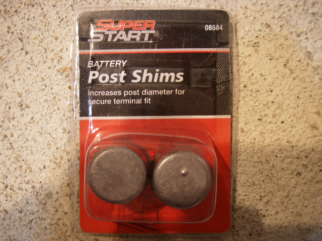

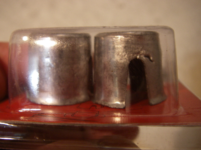

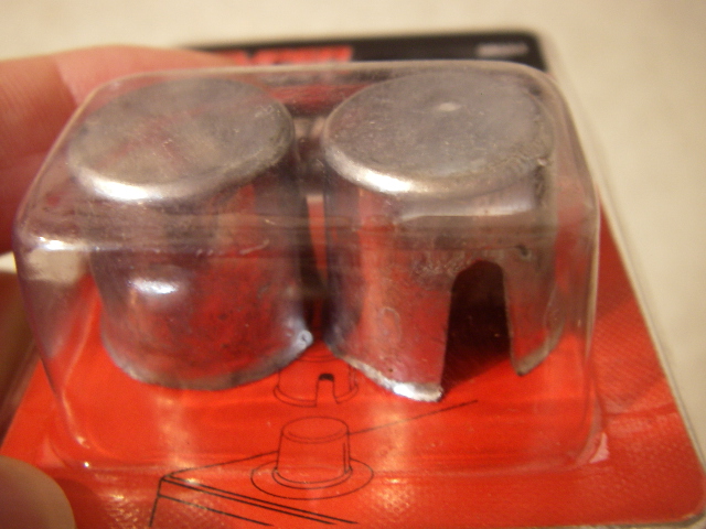

One last thing you'll have to purchase are battery shims. They're under $2.00 and you can find them at any autoparts store. The shims are made of lead and placed over the battery's terminal post to make them thicker. The Yellow Top's post are just a hair slimmer than the OEM's post.

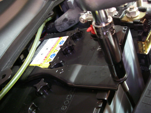

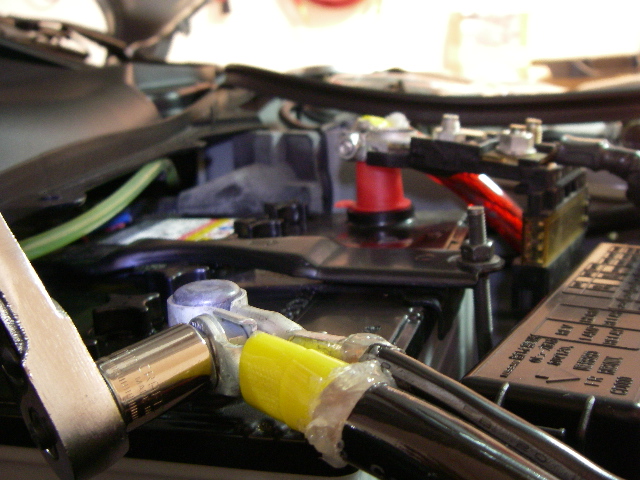

1st thing we do now is unfasten the battery terminals. Always remove the negative terminal 1st, then the positive last. If you've noticed, after I removed the positive terminal I used the red plastic terminal protector that came with the Yellow Top battery, to cover the OEM battery's positive post. This keeps unwanted sparks from flying around while you working on the battery removal.
Next step is to remove the front nut that fastens the battery latch down. You'll need a 10mm deep socket for this one. Notice in the last picture there is a 2nd nut holding the latch down at the rear of the battery. Don't worry about this one. Leave it alone.

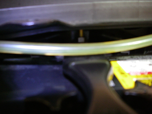

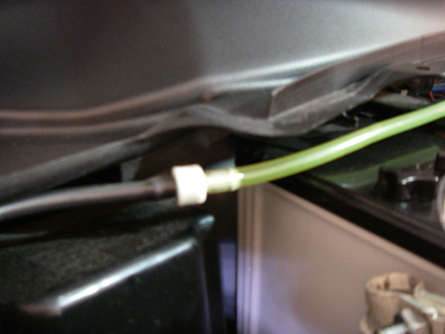

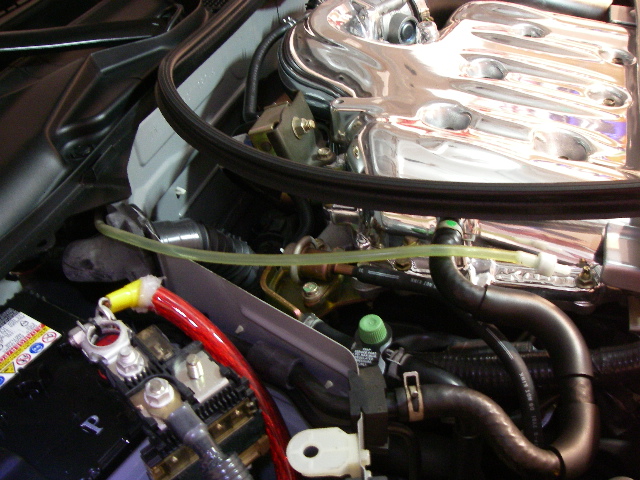

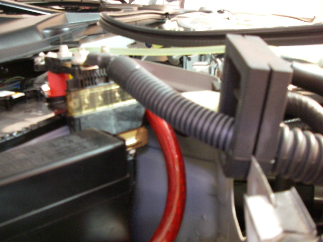

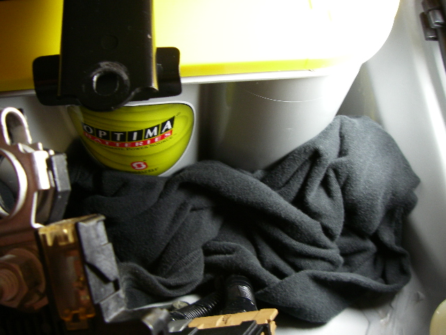

Next we are going to clear all cables and obsticles that are in the way. Do yourself a favor and don't skip this step. You can probably manage getting the battery out without pulling back all the junk that's in the way, but it's not worth it.
You'll have to unplug the windshield fluid wiper hose. The little connector pulls off of the black hose real easy. Unplug it then pull it back and lay it next to the plenum.
Remove the black fuse box by wedging a small screw driver in the little securing tab. The fuse box will not totally come out of the engine bay, but you can slide it out of the way once you'll removed it from the bracket.
Last, pull the postive cable back. But first you'll have to pull the rubber bushing out of the frame.(refer to picture). I use a zip-tie to hold it back and out of the way.

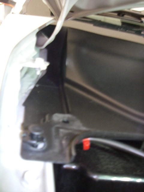

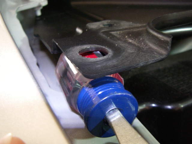

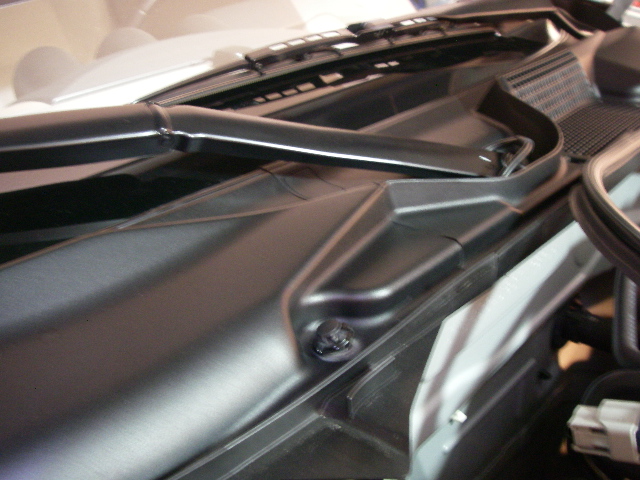

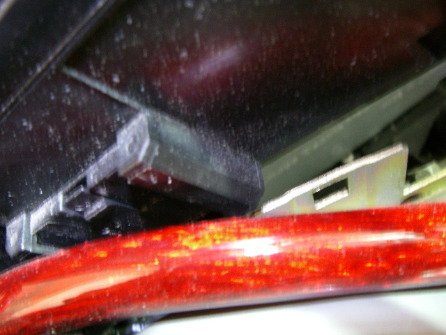

OK, one last thing to do before we remove the battery. This step is important. You won't be able to wedge the battery out of the cubby hole unless you perform this step. We have to pry up on the black plastic panel that sits at the base of the windshield. All you have to do is remove 2 snap rivets. Once you remove the rivets you can see how much I was able to pry the panel up without actually removing it. This gives you an additional 2 inches to work with, which is all you need.
In the last 2 pictures you'll notice I wedge a screwdriver handle under the panel. This is to create the 2 inch gap you'll need to get the battery out, and not have to worry about prying the panel up while you're pulling the battery out.
After all this is done, just slide the battery to the right and pull it out.

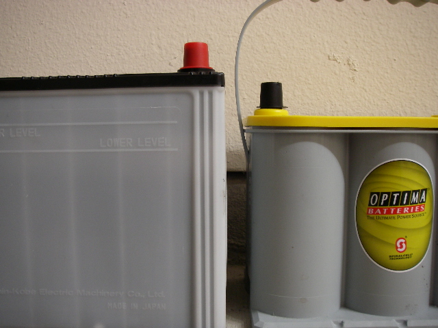

When I performed my previous search, I found a wealth of info but it was hard to tell what was what. So many opinions, so many different statements, and web searches didn't help much either. It seemed every other website had a different weight for the battery.
They say pictures are worth a thousand words, so that's just what I did. In the pictures below you can see the Yellow Top compared directly to the OEM battery. You'll notice their length and width are almost identical and the positive/negative post are on the correct side also. The only difference is the height. But once you attach the spacer, the Yellow Top sits exactly as high as the OEM battery.

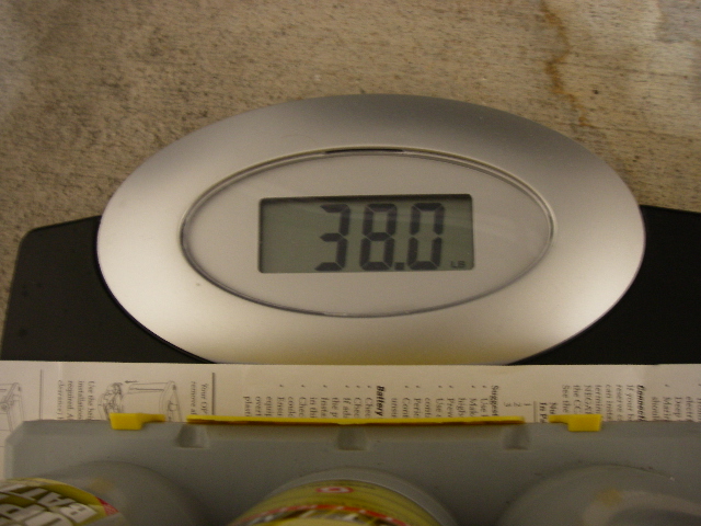

The very last picture clarifies the weight of the Yellow Top. My scale doesn't lie.

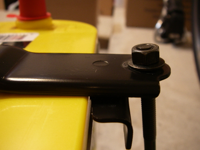

Once I was ready to install the new battery, I performed a test fit of the battery latch. As you can see, the latch is a bit wider than the Yellow Top. It doesn't matter though. It will still secure the battery down very firm.
Make sure to extend the longer portion of the latch towards the front of the battery, when securing it to the car, as seen in the picture.

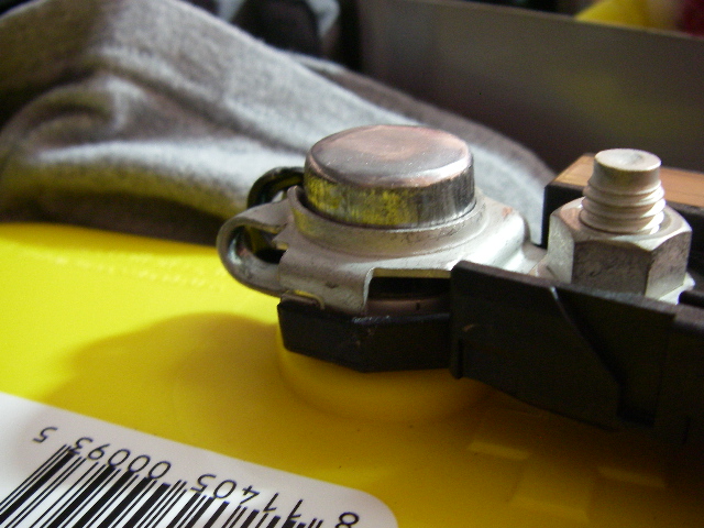

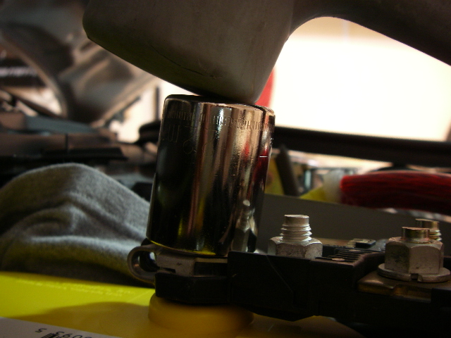

Next we have to tie down the terminals to the battery. This will take a little patience so don't rush it. We start off by placing the battery in the cubby hole. After this is done, get some old T-shirts and wedge them in between the battery and the cubby hole sidewalls. We do this because chances are you're going to drop a nut down into the cubby hole. If you don't have the T-shirts there to stop it, it'll fall under the battery platform. You don't want this to happen because you'll have to remove the battery and bottom platform to retrieve the lost nut/fastener.
Place the shims on the terminal post, then start by fastening the negative terminal 1st. I had to use a rubber mallet to beat the terminals down, on account of the fit being so tight. I suppose you could use a hammer, but you might risk damaging the soft lead post.
For the positive terminal, I needed to get the terminal wedged down futher onto to battery's post. The way I accomplished this was by placing a 22mm socket on top of the post and using the mallet to wedge it down. The last picture shows how far I was able to wedge the positive terminal down.

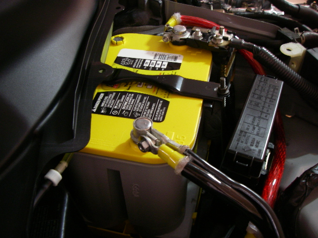

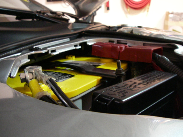

Finish up by securing the battery down with the top latch, removing the T-shirts, refastening the windshield wiper hose and black platic panel, then reinstalling the top cover panel.
As you can see in the pictures, the fittment is perfect. Both terminal cables reached to the battery's terminal post with no problem. There are no modifications needed to the OEM terminal cables.

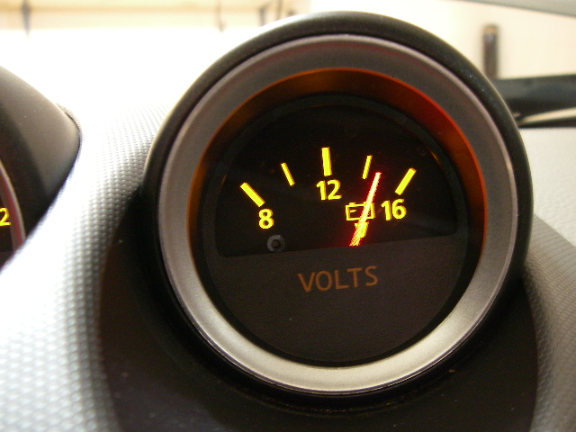

The last picture is what the charge looks like once the car is started. Of course, the alternator has alot to do with the 15volt reading, I thought I'd add the picture for visual effect.
I might add that the car started up in about a tenth of a second!! There's alot of power in that Yellow Top.

Nice guide but one thing i would like to add Vo. You don't have to buy those shims. The terminals fit on the optima perfect. There is even more room to tighten if you want to go super tight. I saw that you had to hammer in your terminals. Not sure if that's something you want to do.
