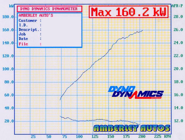

I decided it was best to dyno and see if the A/F changes at all. You can see my stock results below. (5th gear)
This Friday I have another dyno booked to compare any changes.
Q. Is the A/F measurment from the exhaust accurate enough?

Here are my results.....
Old Mar 25, 2004 | 10:29 PM
apsilon's Avatar
apsilon
Posts: 1,934
From: Sydney Australia
Nice little gain considering the rest of the exhuast is stock but look at that AFR.
Old Mar 25, 2004 | 10:38 PM
Flasher's Avatar
Flasher
Posts: 102
From: Aus
Not chasing power so 6 kw was expected.
I was told that its still in a "good" range and not lean enough to worry about. Can anyone confirm otherwise?

I think the AFR is OK but I'd keep an eye on it if you plan any further mods. Your base AFR has more range than most I've seen anyway which may explain a lot of it. Mine is basically 12.5 throughout the entire range for example.

apsilon - I see your point about the A/F ratio after looking at the others in the dyno list you compiled.
They seem very linear compared to mine.
ypwpat - I'd say that yes your AFR would get a little leaner, but your gains would be more than just 6kw (in theory)

I wouldn't be too worried. It's probably a result of that particular dyno and/or the way they fitted the sniffer. Perhaps pull a couple of the spark plugs after you've got a few more km on the cats and see if they look OK just to be on the safe side.

It really varies depending on rpm and load (and probably between types of engines). At idle 14.7 is generally considered to be around ideal but you don't want that at peak revs. You'd like it to come down to about 12.5 under WOT.
Flashers' graph is interesting because it starts out so lean and becomes overly rich compared to the other 350Z charts I've looked at (not that I've looked at that many). If you look at my AFR chart for example it starts off about 13 and comes down to about 12 which is a fairly flat chart.
