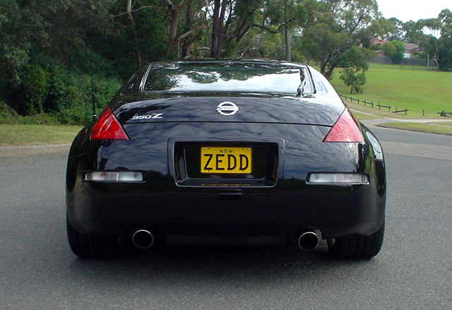

Ok I took the T-Shirt that came with the suspension for a test drive last night. My initial impressions are that its a quality T-Shirt which fits well... Ok Ok I'll get on with the real write up. I must say its been hard to actually get to the computer and not just jump in the car and go for a drive. But now its raining I dont have a choice
If there is anything I havn't covered feel free to ask.
My impressions of the Cusco Zero-2 Suspension, Volk Wheels & S03s are as follows.
Stopping
Stopping distance is decreased, I can slam on the brakes and pull up very quickly. I had a mentally retarded woman pull out in front of me yesterday and I had to do a controlled hard stop(i.e. jam on the brakes), and if I was in any other car there is no way I would have been able to stop in time.
Launching
I can launch harder and be more liberal with the throttle and not have to worry too much about wheel spin.
Handling
This suspension is better than stock in all possible areas. I didn't know what people were talking about when they mention 'bounce' as my Celica was lowered a great deal and must have had similar tendencies but now I have this suspension I can tell the stock suspension did bounce a lot. The new suspension's ride is smooth and bumps are dampened well without any residual bouncing.
In corners the car is very controlled, neurtal feeling and almost zero body roll. I cant imagine what its going to be like when I get the sway bars!? The huge amounts of grip combined with the new levels of control enable you to go around corners at ridiclous speeds. These changes combined with the other qualities of the Zed, make this a fantastic car to drive.
I have yet to try all the different settings as adjusting them isn't as simple as pushing a button, though frequent adjustability wasnt a requirment of mine. In my opinion the main benefits for adjustable suspension over non-adjustable suspension is not the ability to adjust it frequently depending on your current circumstances but more to have the ability to choose how you want it to be all the time, meaning if you would like it to be softer, stiffer, higher or lower then you can change it and your not bound by what the manufacter decides is the best setup for you. Being able to adjust it for a specific circumstance(track etc) is a benefit as well, but more of an added bonus.
Adjusting the front is simple enough, you just pop the hood and turn a dial with a screw driver, but the rear involves a jack as the Zed doesnt have easy way to access the top of the shocks in the rear. I have tried 3 in the front and 4 rear, this results in less direct steering but a good daily driver which doesn't feel much harder than stock. By popping the hood, adjusting the front to 4 and leaving the rear on 4, you get direct steering, more control and a firmer ride which results in a great time on the road. I've only tried these settings but I think 3 for the front and back would be a great setup for daily driving. I have left it on 4 front and rear as the control is amazing. 1 would be very soft and 5 would be very hard and there is enough choice there to satisfy just about anyone. If your worried about the ride being too hard compared to stock, I would erase that worry from you mind as you have the control to adjust it to exactly how you would like it, while any setting you choose is going to be a great deal better than stock.
Steering
The small issue which I mentioned earlier in another post regarding the directness of steering is all but gone now by having the front and back set to the same values. Or at least not having it set harder in the rear.
Sound
The new suspension makes Zero noise, I had originally ordered the pillow mount version but Cusco in Japan recommended the non pillow version because they are noisy, threfore I adjusted my order accordingly. The S03s are very quiet as well, much quieter than the RE040. I found the RE040 to be quite noisy, this might just be because they are a bit small for the Zed's cornering abilities/torque levels but either way the S03s are quieter. I saw somewhere on the net mentioned that the S03s were noisey, but I am yet to experience this and they werent talking about Zeds specifically.
Looks
You really need to see the car in the flesh to get the full effect but Im very happy with it, it looks exactly how I wanted it to

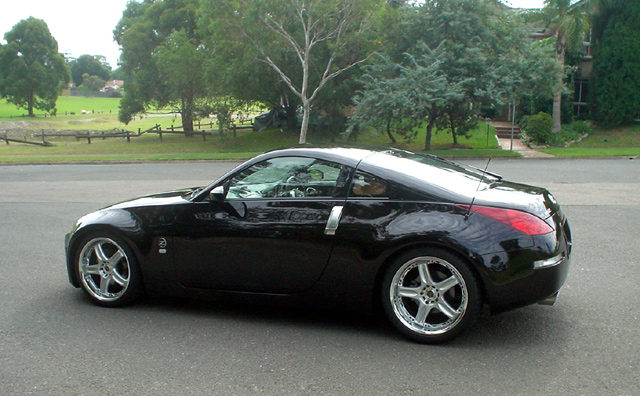

Pic 2

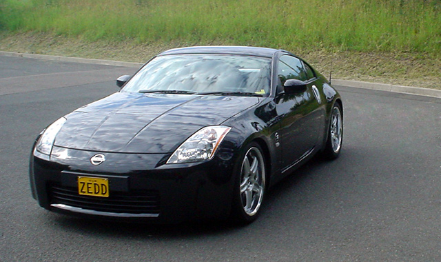

Pic 3

The suspension sounds good, I'm 95% certain this is the setup I'll go with. Like the wheels as well. I keep forgetting you've got a black Zed due to your avatar.

BTW your car looks gorgeous!

Congrats man.... and really happy for ya as you love all your mods, what other things can you ask for besides more better mods?! I am sure you are enjoying even more while you are driving now! and your car is looking good! need some body kits now mate!

Congrates on the car it looks great, now you know how proxy the standard suspension was in regards to the ride quality and yes better sway bars will improve the overall direct feel and balance to the steering.

very very nice car!!
