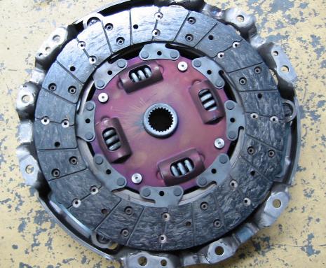

My reasoning of the chatter "noise"
The standard Z flywheel is a dual mass fly where it has internal movement to make enaging easier and smother.
The problem I believe is the standard Z clutch does NOT have the clutch springs on the centre plate hence the dual mass flywheel.
So if buying a single mass fly then it should be matched with a sprung centre clutch not solid.
PS: I have not seen the standard clutch plate so I'm assuming it does not have a sprung centre.

oh... the standard clutch does have springs at the centre..... 4 of them....
RISK:
with the flywheel, the engagement is even easier though, at least that is what I found.... and it makes the driving a lot easier as I mentioned from 1st to 2nd.... less jerky feeling even you let go the clutch fast...

RISK:
