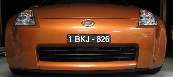

No, don't need to fill or change anything.
Everything can be returned to standard in 2-minutes.
Uses existing screws and plastic plugs that are in the holes as anchors.
Need to buy the very easy to obtain slimline plate covers.
With the plexiglass cover are two pieces of aluminium that are drilled and are the retaing clips to clamp over the plate and cover to retain same. These two aluminium strips are shaped to bend over top and bottom of the plate/cover.
They need a drill hole thru them at a place that lines up with the holes in the bodywork and positions the plate vertically where you want it to sit. (The holes only need to be big enough for the screws to go thru.)
That's it - screw the alu. strips to the old holes/anchors - slip the plate and cover into place - push down the tabs top and bottom and that's it!
Yes - did put a bit of a curve into the plate, but not really necessary.

I've already got a slimline perspex cover for the plates. Although from memory, there was no aluminium plate holder.
I bought my slimline plate cover from Supercheap and the perspex is secured to the no. plate by the use of 4 plastic clips.
So it sounds as though there is no drilling involved in my particular case, just screw into existing holes in the bumper.
Will give it a go on the weekend if I get time and if I don't like it, I can return it to standard fairly simply.
Thanks for the advice.
