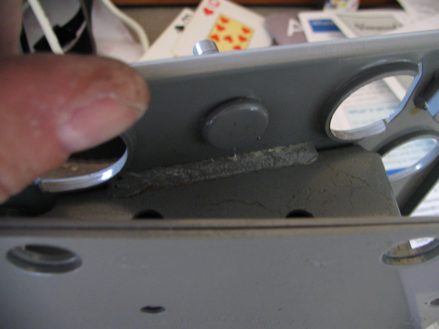

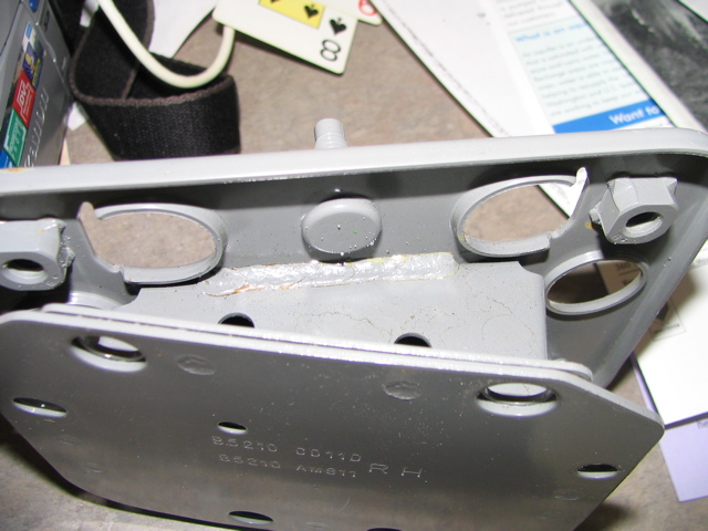

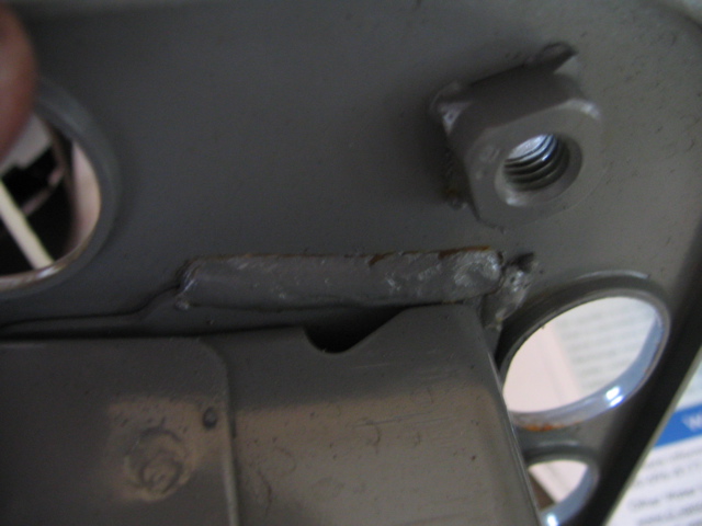

Great hitch guys free bump also. Of note the 05 bumper attachments are much sturdier than previous models. I only put may 2 extra small welds on some keys spots and thats it. The whole thing is boxed in like if you grasped your hands together.

Thanks DmanG281. Did you happen to take any pics of the '05 bumper brackets when you had it all apart?

Default I took pictures
These are some pictures from one of the stock '05 bumper brackets from mine.

Glen,
Excellent. The first two pictures are exactly where I had to add welds on the '03. The weld in the third pic was on the '03 if I remember correctly. Do you mind if I use these pics in my instructions to show the difference between 03/04 and the 05 redesign?

Originally Posted by roark
Glen,
Thanks.
Go ahead and use them.
