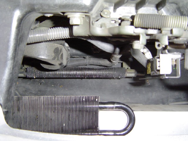

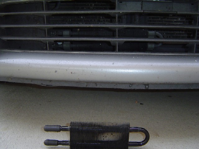

Does anyone have pics of the stock ps cooler next to the Nismo cooler?
Here's the best I've got of this comparison. The installed piece is the Nismo, and the second pic has the OEM lined up pretty closely with the Nismo, to show the size difference between the two. Hope these help.

So the Nismo is about 2" longer than the stock? Not much difference, but I guess every bit helps. I like what Cheston did with the tranny cooler.
