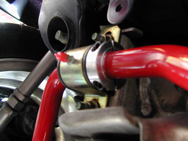

well, mine don't squeak at all, they clunk.
my collars are also on the opposite side of the picture you posted.
i think the problem is my collars are set too far apart, and need to be closer to the brackets.
they do not clunk while on medium, only full stiff.

I bet your end links are toasted. I fiddled with collars and regreasing, even checked to make sure nothing was rolling around in the spare tire well. On inspection I never got any free play out of the old links, but bought some new ones just because of the noise. They're cheap ($13.00 or so each) and the factory replacement units had bigger ball joints than the stockers. It's worth a try.

The collars keep the Hotchkiss bars from moving laterally. A lot of the bars have flanges on them that keeps them centered, but the Hotchkiss don't. Mine became noisy, too, and re-greasing them quieted them down immediately. I'm going to add the grease fittings as described above. I haven't tried the 350Evos, but the Hotchkiss are a huge improvement over stock.
