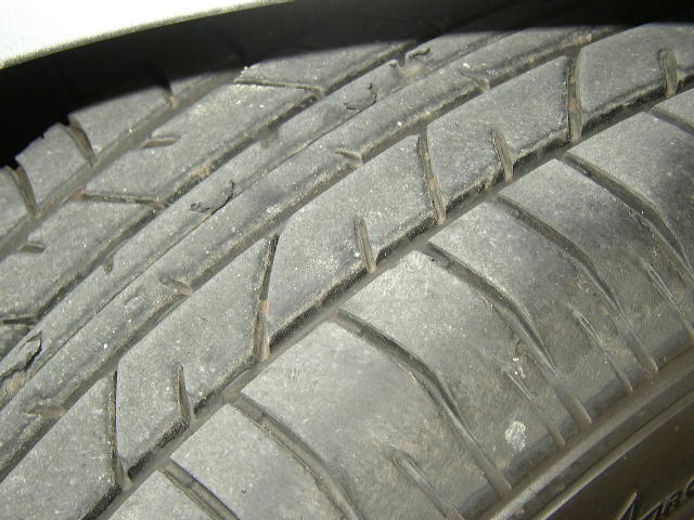

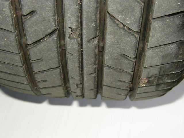

My 1st season tracking, my Bridgestone's held up through 12 track days. Yea, they started to.....chunk?.....a bit, but you will be fine. I tried my d*mnest to trash them, but I never succeeded.
Here are a couple shots after about 4 track days:
