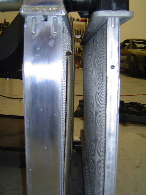

Here is a picture of the stock radiator next to a three core Koyo. That is a lot of cooling advantage.

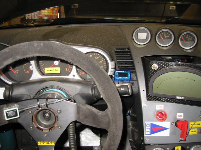

Fairly inexpensive and easy to read, however no data logging capabilities other than peak hold. if you want a fully instrumented water temp sensor, perhaps the Cypher from Altered Atmosphere with a laptop would suffice. for just checkouts when tracking and 'knowing when to quit' CMX is great.
CMX info:
http://www.technosquareinc.com/cmx.htm
the little blue thing near the vent
my thoughts on huge radiators: as long as you have good air flow for heat exhange/extraction i beleve a normally sized core is good enough. if it's too thick, that thing will act like a heat sink. you need ALOT of good airflow thru a thicker core to get sufficient heat exhange. i've seen some cars actually read higher water temps with a triple core koyo.. but other factors might come into play such as poor planning/placement of other things such as intercooler and or lack helper items like fans.
