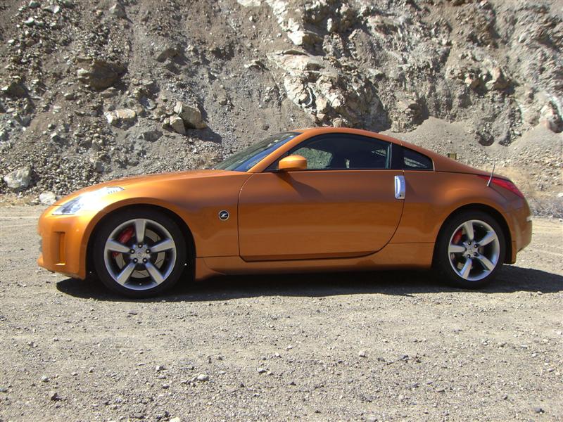

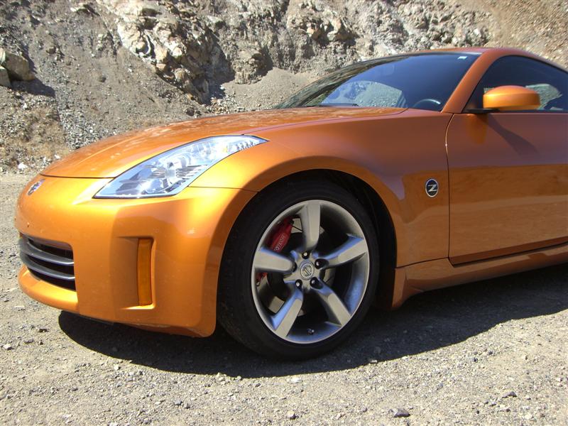

Ok, so I'm geting conflicting opinions here...
Sincity350z, I have 18s not 17s and they clear the 14" StopTechs F/R fine. 17s probably would not fit though as the calipers are just a few milimeters from touching the inside of the wheels. The attached pictures don't show detail but you can see they fill the wheels pretty good...
Attached Thumbnails Wheel and tire questions-cimg1238-medium-.jpg   Wheel and tire questions-cimg1239-medium-.jpg
