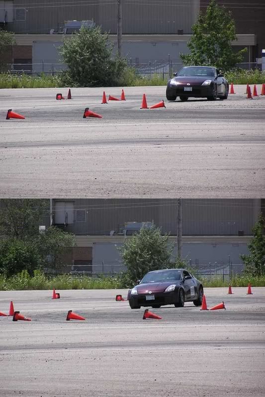

The Hotchkis drop is very subtle. I only got just under 1" up front and btw .5 to .75" rear drop. The only problem is that they are a little soft - especially for R compounds. In the pics below you can see that I actually managed to pick a tire off the ground, and the one below that shows how much compression the rear goes through in a quicker corner.
