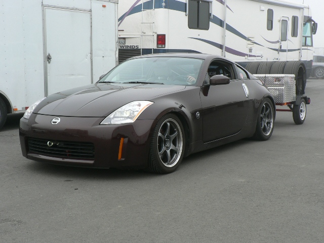

Default Four Years towing This Trailer
I built this from Northern Tool High speed trailer. The Aluminum box also from Northern and the wheel cariaer is my design and made locally. Total cost 700.
