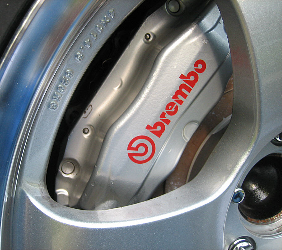

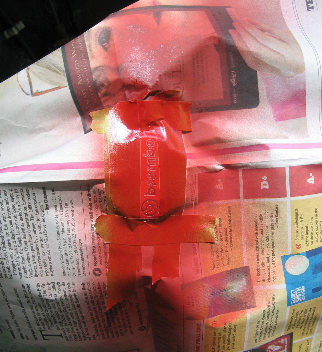

The final touch, weeks later than I expected: painting the Brembo logos.
Not really much to tell: I had my local sign shop make the stencils in vinyl, I applied them, masked off the area, and sprayed them with three coats of red High Heat Duplicolor paint. After the paint dried for an hour, I removed the stencil, and there you go: a custom, one-of-a-kind Track caliper paint job.
Attached Thumbnails Rebuilding and repainting Brembo calipers-img_1116a.jpg   Rebuilding and repainting Brembo calipers-img_1118a.jpg   Rebuilding and repainting Brembo calipers-img_1119a.jpg   Rebuilding and repainting Brembo calipers-img_1127a.jpg   Rebuilding and repainting Brembo calipers-img_1129a.jpg
