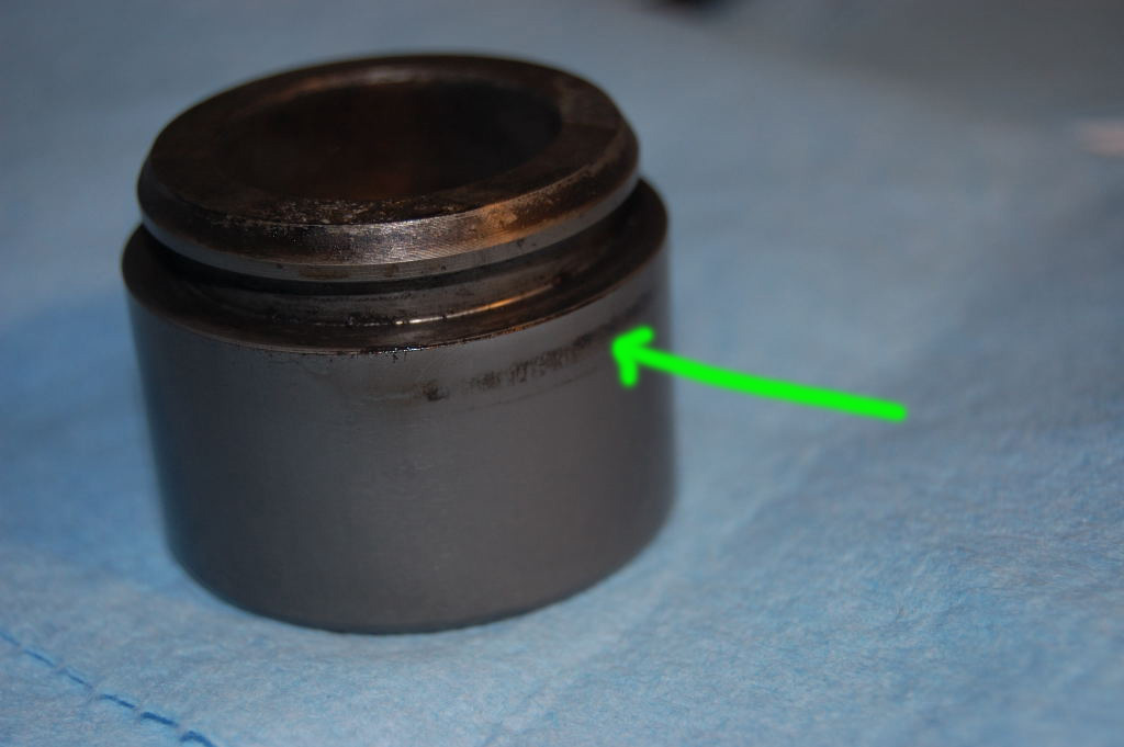

Default examining parts during the rebuild - replace piston?
Had to bump this old thread because it is an awesome DIY.
During my rebuild, one of the pistons was pretty dirty. I was able to clean it up with assembly lube, but this little ring remains. Is this scorched? Should I just replace it? or am I being paranoid?

That was the one and only time I did that job, so I'm no expert, but I'd try to clean that gunk off if I could. Maybe some very fine steel wool? Unless you've had some problems with that caliper, I don't think you need to replace the piston. After all, it's been like that for a while. You haven't made it worse by rebuilding.
Perhaps someone else with more experience can offer a suggestion. Or contact Dave Z. at Zeckhausen Racing for his advice.
If there is a raised surface you can feel with your fingernail, you should probably try and remove it. You're not supposed to use steel wool (although I can't remember why, or provide a reference), but emery cloth or Scotchbrite is OK. Of course, there's also a good chance that doing nothing will be OK, too.

Yeah, now that I think about it, even fine steel wool could score the surface and create problems. Something softer, like dcains suggests, is probably best.

Thanks for the replies. I used a new/clean rag and assembly lube - they cleaned up. Scothbrite pad probably would have quickened the job a little.
There was no raised surface to the dirty spot that I could feel... maybe I am being a little too meticulous. But, I know what it's like to have brake issues; I want to do anything I can to avoid future problems.
