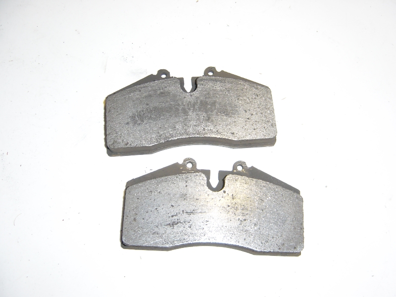

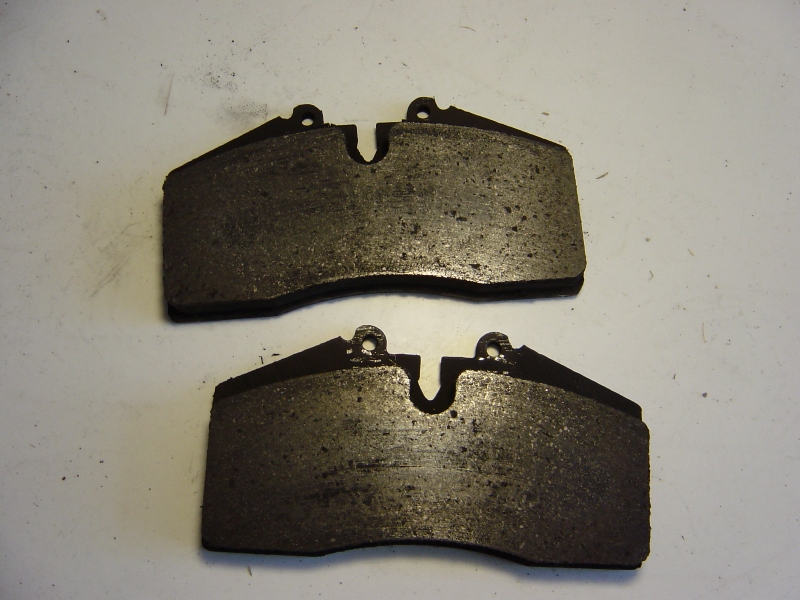

So I went to Thill yesterday using the Axxis Ulitmates in the front 13" Stoptechs and Hawk HPS in the stock rears. I was running in the intermediate group all day. We had 5 20 min sessions. Worked fine in the earlier sessions since the temps were not as high. By the latter part of my 4th session with the outside temps at 103 deg my brakes faded badly going into turn 14. Almost lost it but with the help of my coach was able to recover nicely without incident. Now my brakes are a little soft. I'm guessing I boiled the fluid a little bit and need to bleed some out. I'll also pull the Ultimates out and check the condition. Now I'm definntely going to get some upgraded pads for sure for the future. Going back to Thill again in Nov. At least the temps will be much more comfortable.
Old Jun 17, 2007 | 09:16 AM
dklau33's Avatar
dklau33
Posts: 516
From: Bay Area
Bled the brakes a little bit and got about 4 or 5 air bubbles out. Other than that the brake fluid looked good. Pedal is good now. Here's how the ulitmates looked like after I pulled them out. A little bit of glazing? Or is that exactly how they are supposed to be?
