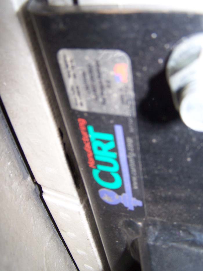

Is that the curt one?
Ahh ok it is, thanks

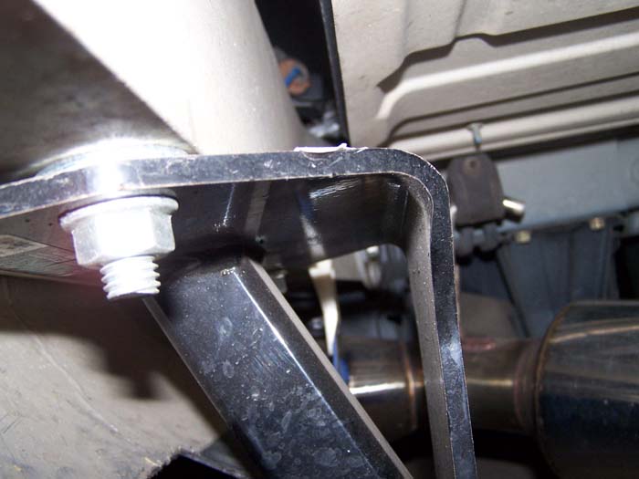

it looks as if the hitch would hit on a stock muffler.
are there any other bolts than the two on the bottom?
or are there two on the back of the bumper also.

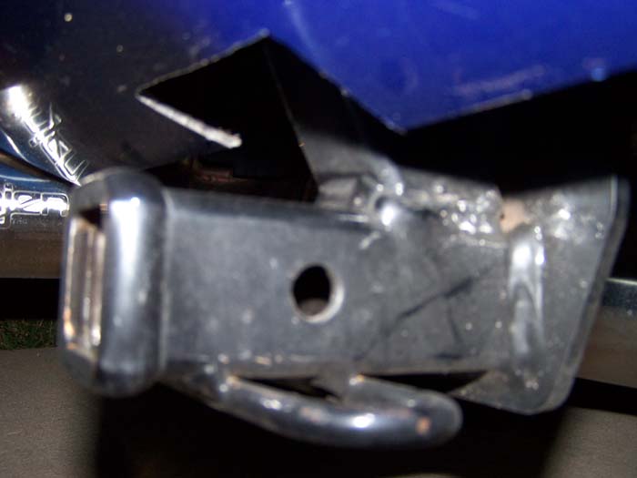

Originally Posted by Billhyco

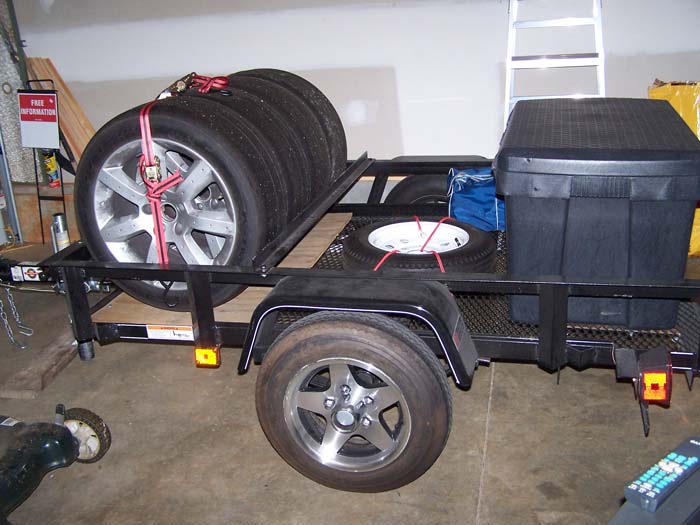

well it was dark tonight when I took the pictures but you will still be able to get the idea...any questions just ask. There are two bolts that come straight in the back of the bumper and two come up from the bottom of the bumper.
That looks great.
You mentioned that you had to cut some 4x4 pieces, is this from the bumper? Also, is it something visible/permanent (in case when it comes time to sell the car) ?
Also, how much would a trailer like yours cost?
I just emailed the DropHitch folks, to see if they have anything that will fit a G coupe. Their website only lists one for a G sedan. *fingers crossed* !

you can see in this pic the 4x4 square that I had to cut out. that is approximate size but honestly I screwed up. You would only have to cut may a 2.5" wide slot maybe 4 inches deep.
there are four bolts total that you have to use. if your standing behind the car, two of them go straight in, then of course there are two that you can see in the pics that go up into the bumper from the bottom. the directions said to cut a 1.5" center hole in the bumper to get all the bolts in but I skipped that and just used a LONG piece of wire to fish the bolts inside the bumper. its was faster and seemed safer then cutting a big hole it in. the bumper drills very easily, its basiclly looks like thick layers of aluminum. And no matter how many threads I read, it was still twice as easy to get the bumper cover off then any of them said it was. its really an easy process..just seemed a bit over whelming in the begining. Not sure how it would work with a stock muffler. what someone would need to do is measuer the distance from a stock system to the metal bumper. the hitch prolly sticks out beyond the metal bumper, under the car maybe 2 or so inches. so if the stock muffler actually sits that close then it may not work. i don't think the stock system fit that snuggly by the actual bumper tho.
the trailer from TSC (Tractor Supply Company) I think was around $450.00 the guy I bought it from had purchased the mag wheels to match his vette so he says. but the white wheels that came with it would have worked just as well. he welded on one piece of angle iron to hold in the tires, drilled some holes for the tie down straps and that was it. I ran 70-80 on the hwy last track event and ya can't even tell its back there. Doesn't sway, doesn't push the car, its super light so when I am home I just push it in the garage by hand.
