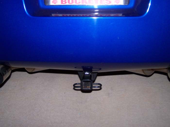

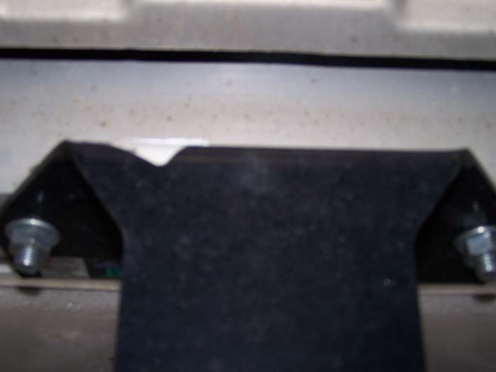

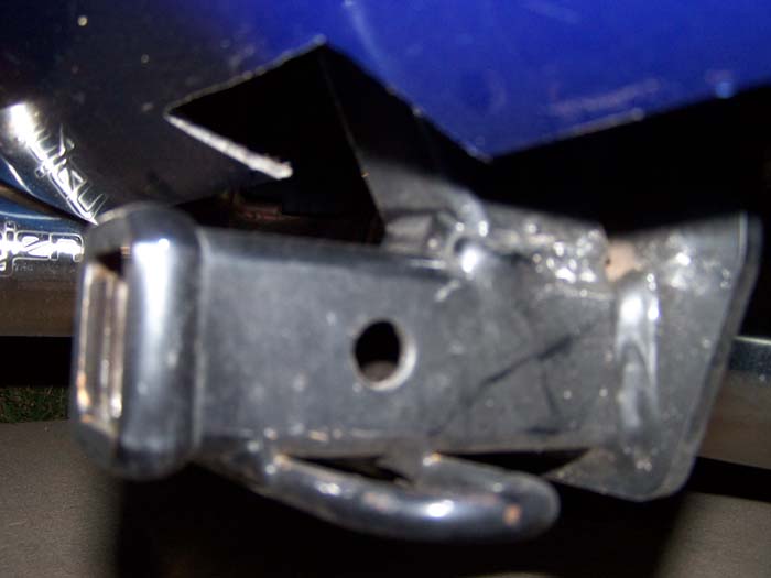

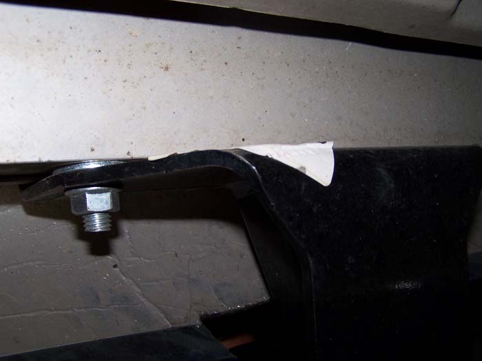

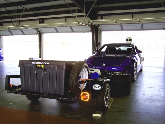

that is the site i bought mine from. It looks NOTHING like the one in that pic on the page, however. It mounts to the metal bumper under the bumper cover. I only had to cut maybe 4 x 4 section. I could have kept the amount of cutting down but a mistake made me cut more out. It only took maybe 3 hours to install, wasn't hard at all. If you want some pics of the finished product let me know I will see what I can come up with. I pull a 4 x 6 TSC utility trailer, 4 tires, tent, jack and tool box without a problem.
edit: i bought my trailer from a guy that used his Z06 to pull it. my hitch is WAY more stealth then the one in that thread above that First350 used on his car. so to the hitch haters, either you don't race, you don't race worth a ****, or have to much money and should give us poor weekend warriors a little to live off of.
pic of the trailer.....

well it was dark tonight when I took the pictures but you will still be able to get the idea...any questions just ask. There are two bolts that come straight in the back of the bumper and two come up from the bottom of the bumper.
