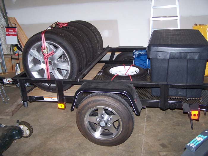

Originally Posted by frizille
Can you link the trailer? I'm looking at options between a whole flatbed trailer I can tow with my Tahoe and something to hold the tools/wheels then just pull it with the Z.
man if i had the option i would pull my car EVERYWHERE!!! but here is the trailer i use -
http://www.tractorsupply.com/webapp/...stingPage=true
its the one without the ramp....i have different wheels but that was purely cosmetic. welded a bar to hold tires and mounted a nice plastic/lockable box to the back. still have room for another set of tires if needed. comes with the lights and jack.
Actual pictures of my trailer... https://my350z.com/forum/attachment....9&d=1201571480
Old Mar 3, 2008 | 03:23 PM
frizille's Avatar
frizille
Posts: 269
From: Atlanta
Thank you sir! I think this will be the route I go... just from a cost perspective. If I save a couple grand on the trailer thats a couple grand I can put somewhere else - engine, brakes, etc.
