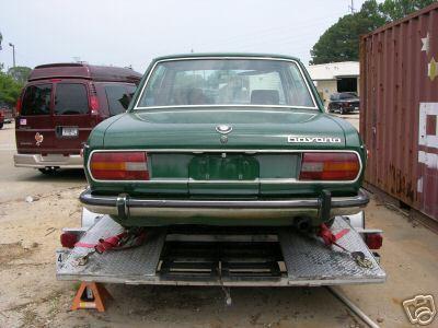

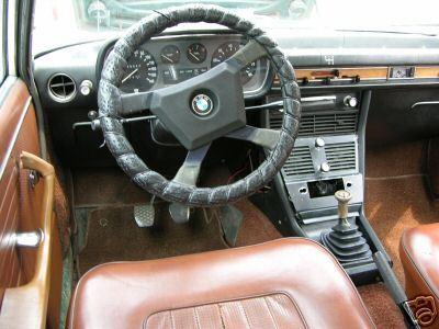

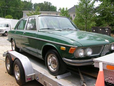

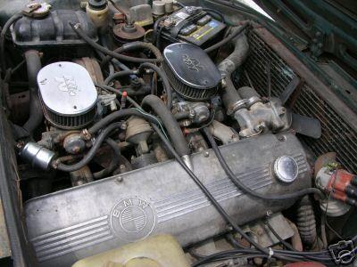

I figured it'd be fun to chronicle our build for our 24hrs of LeMons entry. We will be competing in the race being held on October 18-19 at MSR in Houston.
We did find a car and have begun working on it feverishly as this build is being done in conjunction with our Grassroots $2008 Challenge car. We wanted a car that was pretty much running and could get done relatively quickly. Well we didn't really hit any of those milestones. We picked up a 71' Bavaria from a group of guys in Atlanta that had started working on it for the 24hr race already.
The car had previously begun a restoration and luckily came with a full rebuilt clutch/flywheel and its trans had apparently been looked through. So that was nice. We also were lucky enough to find a parts car at the local Pick and Pull that we cleaned the suspension out of. Both very big pluses in our quest. One of the problems right now is getting the carbs rebuilt but once it is warm it pulls pretty strong. The previous owners bought the kits to rebuild the dual webers. They never actually rebuilt them but only cleaned one. So currently we have one that is blocked up and another that is spitting gas so that will be first on the agenda once we get to fixing stuff under the hood.
Another problem is the brakes or lack there of. These old cars actually came with 4 wheel disks with 4 piston calipers in front and 2 in the rear. Another pleasant surprise. We dipped back into the car at the Pick and Pull and snagged all 4 calipers for 40 bucks.
And then there is the rust. Apparently there was only supposed to be a small rust on the front frame extension. Well as with most things bought on ebay that was the least of our worries. The car basically has no footwells left. What footwells there are, are held in by sound deadening and carpet. Luckily the seat supports are still firmly attached so we just plan on replacing the footwells with sheet steal. We also found 2 rats nests when taking apart the interior but luckily no rats.
I'll be updating this as frequently as I can if anyone is actually interested. Here are some pics before work started.
