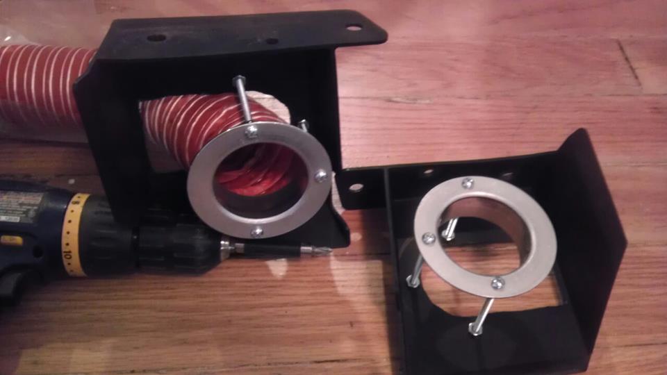

These are all the pics I took from my install. It took a little while, but it was my first time installing brake ducting on a car. I'm sure i could do it even faster now. So I was hooked the moment i found out about the Nismo carbon fiber Ducts, the reason for this install is that and I drive the Nurburgring regularly, and that track is notorious for pushing your car to the limit, especially your brakes.
I went with 2.5 in. flanges. from www.aircraftspruce.com
Went with 4 1.81 in. to 2.75 in. clamps from www.pegasusautoracing.com
2.5 in. diameter, 12 ft long piece of neoprene ducting. you will use the whole hose, just cut it in half. it fits perfectly. I got it from www.pegasusautoracing.com
and i ordered the Nismo Ducts from www.Ebay.com
drilled out the grill shields
assebled all 3 pieces with 4 rivets each
disassembly of rotor and caliper
removal of Dust shield and Hub assy.
before my cut with the tin snips.
you will have to snip both sides. i originally wasn't going to put them back on, but upon closer inspection i noticed that there was a gap if you just put the hub on the spindle. so this was the easy work around.
the finished result
you will have to file down this little raised section on the spindle in order for the ducts sticky tape to be effective.
onto the other side
make sure you check your gap. you don't want the duct or the aluminum bracket rubbing against your rotor.
what it looks like inside the duct to the rotor.
take off this piece. only three snap clips hold this piece in. i ended up using a saw zaw to achieve this cut. a bit of over kill.
you will have to relocate this harness, just like i did with the zip tie.
make sure you check your clearances. rotate the wheel full left and right.
put her all back together, go home cool off with a good beer.
