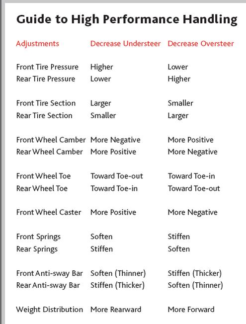

Right now got my dampners on full stiff up front and half on rears. What kind of setup would yield the greatest grip in a turn. All I have is coilovers.

This is what I have been using

great info thank you!
