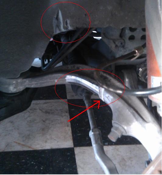

Old Oct 1, 2010 | 06:07 AM
JasonZ-YA's Avatar
JasonZ-YA
iTrader: (60)
Posts: 11,204
Likes: 32
Minimum of 9 inch front wheel, then you don't have to upgrade for 275's. Then 10.5's with 275's all around is pointless when you can easily get away with 9's or 9.5's that will be lighter.
OP, i completely agree with this......
9in has been an overall great wheel size for the Z..........
Moreso on drifting, but still pertinent:
going wider you must be on point with offset, or use the addition of spacers to ensure a proper offset to avoid Compression arm contact with the inner rim lip...
shown here:
either way, i see this with peeps that come over and have really wide wheels up front...
Steering Rack:
the factory steering rack has to work harder......I see everyone with leaking racks that run really wide rims.....its known the end seal isnt all that great, but doing 10.5's up front kills it quicker..
plus like already mentioned a 9" can be lighter wheel...
-J
