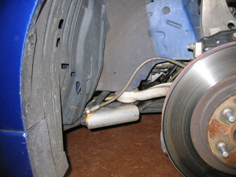

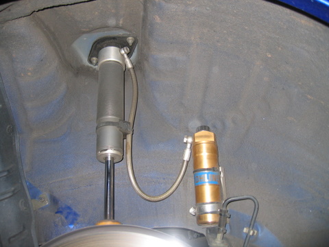

Here is where mine have been mounted for the past 5yrs or so.
Attached Thumbnails Coilover external reservior mounting-shock-pics-007.jpg   Coilover external reservior mounting-shock-pics-001.jpg
Thank you, sucks my hoses are way to long for that. Well rears are temp mounted for now, just need some hardware to finish them up properly. Looks like the rears will be mounted on the bottem of the trunk. Fronts are next, tomorrow evening. Then i can sell off my BC's.

I will bet whoever had the shocks before had mounting rules to contend with. John is correct about shorter is better, though I would not call it better responce as much as I would call it better damping or more consistant damping. IMO make the hoses shorter and mirror hippie's mounting system. This is true even is your using really awesome material in the hoses. You've got good shocks now, it's not a area I'd compromise. IMO.
