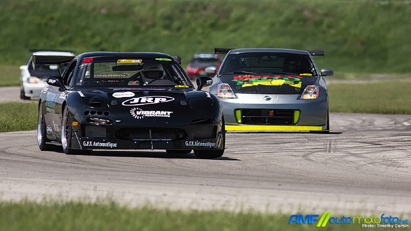

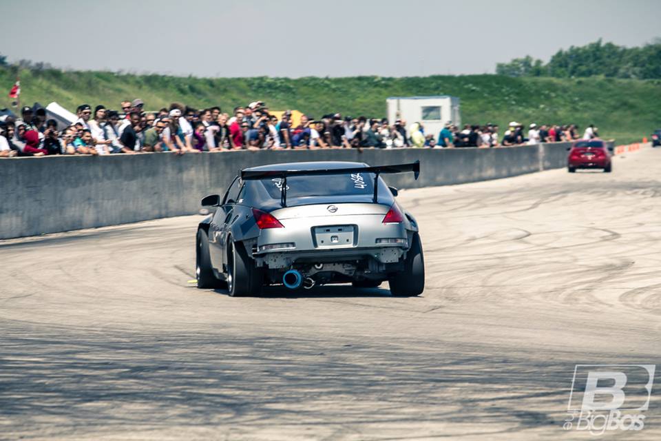

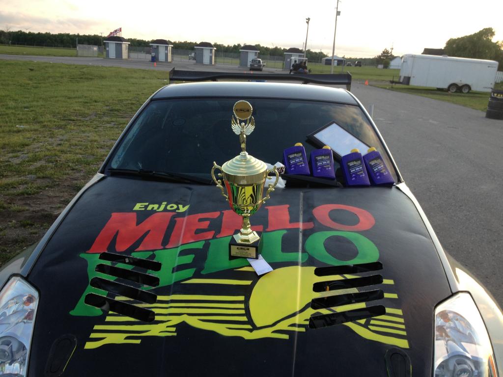

CSCS round 1 recap.
Worked to get car ready. Was first real test of the new set up. I was confident of a 1:18 when I showed up at the track, but ring rust, and a lack of experience lead me to a handful of 1:20.1s officially. Some said the track was slow due to a full day of heavy rain the day before. Others said the fact that I mounted my Hankook TD's backwards played a role. lol.But more so I would say it was having my confidence tweaked a bit by ABS electronic failures, the ecu occaisionally limiting me to 160 kmh and the frustration that causes, and a desire to keep my new splitter in one piece.
I did have a 1:19.84 if you count Aim SOLO laps in dashware where you can move the start finish line a little with ease to find the fastest lap.
I actually lost the key to the 350Z for about 45 minutes before the time attack. So that was a potential disaster.
Uh, could go on about stuff, but. too lazy. I prefer videos and pics.

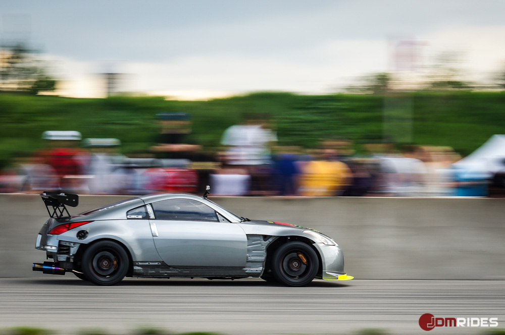

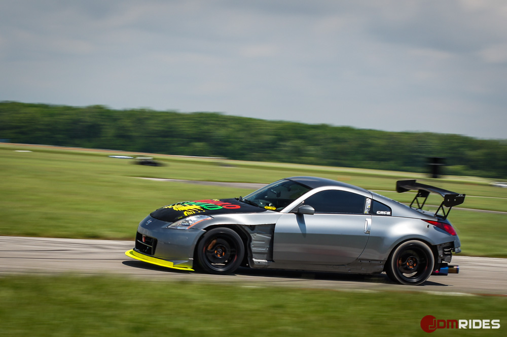

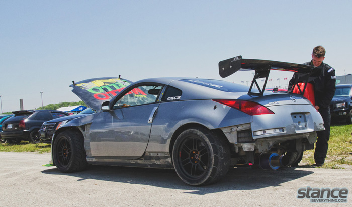

From: London, Ontario, Canada
Things I am thinking about doing before June 3rd.
Stiffen anti roll bars? Car rolled all over the place on the R comps
Stiffen the rear shock setting a couple clicks. Understeer like mad I couldn't get rid of. Likely due to APR wing, and
decrease splitter angle to get the front closer to the ground. In some pics I notice it looks like it's pointed up. That and the car rolls a lot!
I need to get VDC issue looked at. Might be a wheel speed sensor signal issue? or who knows. But needs to be looked at for sure. Cant always be worrying about ABS kicking off at random

I would think those front fenders are creating a lot drag, I think I would be high on my priority list. The idea is there, just need to finish them

That's what I saying....I'm no astronaut, but the door is catching air, isn't it?
other aftermarket designs for fenders have a flap moving the air away over the door...

After watching your vids I was going to suggest the fenders, lower stiffer suspension setup, and using 3rd gear more instead of 2nd. 3.9 gears might work out for you too.

Believe me I experimented and experimented with 3rd and 2nd in certain sections. I might just go back to driving it the way I drove it to a 1:20 last year and see where the chips fall, even if it doesn't look right.
Yeah, hopefully what I call the door shield will go on before round 2.
I won't buy new suspension this year but I will work to tune the one I have as the year goes on.
I don't need new gears, I need the 1000 extra rpm I'm supposed to have, but can't because of fuel problems. But now I have GTR injectors and Walbro fuel pump. Those may or may not be installed before round 2... but have a real chance of being in round 3.
Still. After thinking about it. 1:20.1. No seat time in 8 months. Totally foreign car, completely not set up. Not finished. Understeering. Never used R comps before. ABS ECU issues. Only 2 drivers on R comps out of everyone driving in all classes were able to beat me and not by much... Not a bad first outing.
