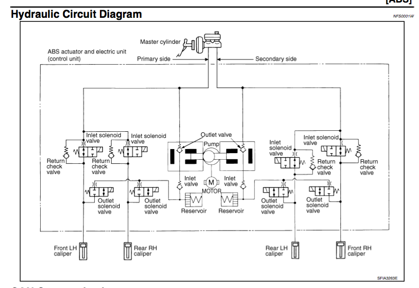

By the way pchio, when you plumbed your abs did you switch it from left/right to front/rear for each circuit in order to adjust rear bias?:
Attached Thumbnails ABS Problem on track (Video), How to ABS delete?-picture-1.png
Yes, Circuit are separated from front and rear now.

Do it at your own risk, I wont be responsible for anything happen to this brake modification. Not for street use at all.
These got me a few days, planning, researching to gather all the parts. Metric fittings are very difficult to find!
From Master Cylinder:
(2) 12mmx1 Metric to -3an Adapter Male
(2) -3an Teflon hoses 10" and 18"
Front Brake Circuit:
(1) -3an male to 10mmx1 male adapter
(1) 3 way Tee 10mx1 Bubble flares adapter
Rear Brake Circuit:
(1) Wilwood Brake proportioning valve 1/8NPT fitting
(1) Wilwood remote brake bias adjusting cable
(2) -3an male to 1/8" NPT adapter
(1) -3an Teflon hose 6"
Tool:
Eastwood Company Brake Line Forming Tool
A few custom brackets to hold everything in place.
